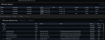

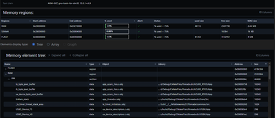

mbarg.1
Senior III
ThreadX takes control of your app and rtos diconnect ..
Seems ok
PierreB
It works as expected with a smaller stack size
Did you check Build Analyzer - Memory details ? Can you share? with small and large stack?
With 10240 stack size
With 1024 stack size
The debugger "crash" at the line "previous_thread -> tx_thread_created_next = thread_ptr;" (line 258) in the "_tx_thread_create" function
