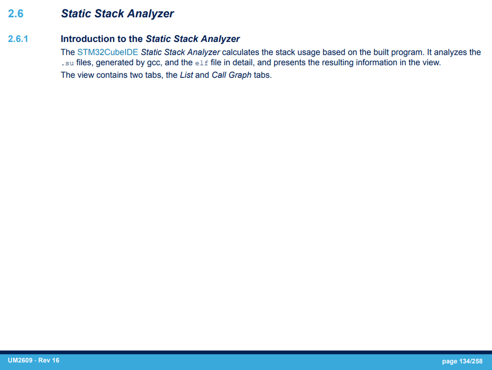

Does anyone know if there is a stack analyzer tool / plugin available in CubeIDE, in particular to analyze the stacks dynamically allocated in ThreadX Memory pools?
Also, under ThreadX Thread List, there is a "stack usage" column.  This column is always blank (or N/A), is there something that needs to be done to enable the "stack usage"?

Same. I would sure love if someone from this huge company could answer this. ST? Hello?
In the User Manual:
https://www.st.com/resource/en/user_manual/um2609-stm32cubeide-user-guide-stmicroelectronics.pdf#page=134
Also, as CubeIDE is Eclipse,  you could try searching for general Eclipse-based stuff...

You can enable the stack view with the "Hamburger" button:
