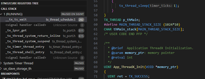

During a debugging session, when `tx_thread_create` is called with a "big" stack size (1024*10 for example) and the "serverRtos" is enabled, the debugger is disconnected with an error: "Remote communication error. Target disconnected: No error."

18 REPLIES 18

The thread creation with min stack size "#define MAIN_THREAD_STACK_SIZE (1024*10)" is causing overlap between .bss and ._user_heap_stack

I tried implementing your suggestion, but unfortunately it doesn't work any better. The issue persists even after allocating the stack from the ThreadX byte pool as you described.
I have the impression that the problem is elsewhere because it works correctly on STM32CubeIDE.
