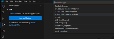

But how to flash my code to the board
Cartu38 OpenDev
Lead III
@Elite board flashing is done at debug session launch time. Have a try !
