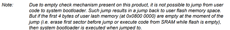

This article will not cover the workaround of erasing the first page, but the code will have all STM32s addresses in it to facilitate the implementation, in case the reader wants to use it. We do suggest reading this article that explains how to execute code from SRAM.
Assuming you are using a series that allow you to make the jump from the application into system memory, we need to be aware of some important and necessary steps to be performed and some notes to keep in mind:

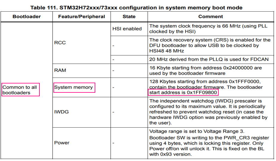

1. How to find System Memory / Bootloader Start Address value:
Refer to AN2606 “Configuration in System Memory Boot Mode” tables. Each device will have a specific System Memory/Bootloader address, and this value must be known to jump to bootloader correctly.
For example, for the STM32H723ZG microcontroller (a quick article showing the code for this series is available here), the Bootloader doesn’t start from the same address as the System Memory, but this is clearly defined in Table 111.

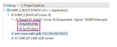

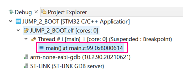

There are different useful ways to test if the code worked successfully, two of them are explained below.
2.1. STM32CubeIDE debugging tab.
You can check whether the PC is set to the Flash or Boot address in the debug tab on the top left corner of the debug perspective. At first, the PC starts in Flash address: 0x08000614 (for this particular demo).
After entering the Bootloader, the PC is now set to an address inside the Boot region: 0x1FF127BC. You can see the tab below after hitting “pause” button.

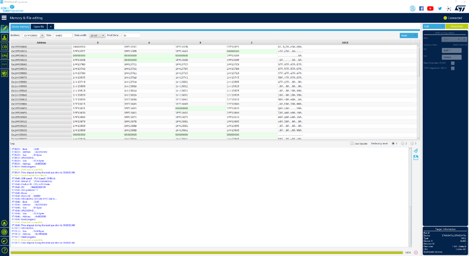

2.2. STM32CubeProgrammer Tool
Once within the Bootloader region, we can use the STM32CubeProg to guarantee that the system is working in system boot mode.

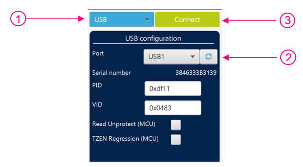

For this tutorial, we will use the USB entry point to perform this, but other interfaces available for the given series could be used as well. Just keep in mind that the USB has higher priority than the others, so if the cable is connected it will be the one selected. The AN2606 covers all of this peripherals and needed settings for all series.
Obs.: Please pay attention to the pins specified in the AN2606, because even if the STM32CubeIDE allows the pin reallocation, to enter in bootloader the pins must be the same as in the Application Note.
To execute this over USB, connect the USB cable on the User USB connector. After that:
- In the right corner, select USB instead of ST-LINK
- Refresh the Port to recognize the USB
- Hit “Connect”
After connecting, search for the Bootloader start address and you will see something similar to the following image.
You have now successfully jumped to bootloader from the application. Well done!

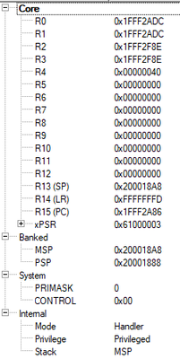

We can see the PC is in the system memory area, however when we try to connect with STM32CubeProgrammer over UART it doesn't work. MSP/PSP don't seem to change at all.
We have used this method on a previous project with an STM32U535 with no issues.
We've also used the option bytes to set nBOOT0 = 0 and enter the bootloader that way with no issues
- Mark as Read
Look at the code generated by the compiler - under CubeIDE you may see it in <projectname>.list file. Find the place with __set_MSP() and check if the instructions after MSP setting use sp register. If so, the jump will be incorrect. Current GCC emits the code using sp with optimization levels below -O2. Just set -O2 optimization and this particular problem disappears.
- Mark as Read
We're using Keil for this project - do you know how to check the instructions here? In any case, we've tried setting -O2 optimization and it has had no effect.
If it helps, this is the state of the registers after the jump:
When we entered the bootloader via the option bytes, I noticed a couple of pins obviously change state. I do not see the same changes when we try and enter via our application, so I'm assuming we're not fully entering the bootloader for some reason?
Thanks in advance

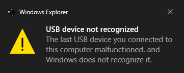

Did anyone successfully jump to the bootloader in a G4? I have a stubborn G473 where I can't get the USB port to work in the bootloader, when jumping from the application. If I use the hardware BOOT pin it works fine.
With some help from this thread, I got it working in an L4 more than a year ago, and thought that I could use much the same code in the G4. Except that I would need to add a memory remap line. But the USB port fails to connect properly with the computer, as is evident in this message:

Does anyone have a good guess at why the USB port doesn't connect properly with the computer? Is there something I need to set up in the USB port before making the jump?
Any help will be greatly appreciated.

I really like your solution. Easy to understand and implement, and gives a "clean start" of the bootloader.
However, it still doesn't work on the board I was struggling with earlier, and I have a hunch that it is a hardware problem. The USB connector on the board (which is only going to be used for firmware upload) is a USB-C connector. I have connected the CC1 and CC2 signals on the connector to CC1 and CC2 on the microcontroller, but this might have been a bad idea, as I have no idea if the bootloader configures these pins. Probably doesn't. Maybe I should have used the usual 5.1 kΩ resistors to ground as I've done elsewhere.
- Mark as Read
No, that's not it. I had forgotten, that when I force the bootloader into action by using the hardware BOOT pin, the USB port works nicely, and I am able to upload firmware through the port.
But when I invoke the bootloader by making a SysMemBootJump, even with the clean and simple method by @m4l490n , then Windows tells me that the USB device is unknown and doesn't work properly.
This is so confusing, and a bit worrying. Any help to shed some light on this would be greatly appreciated.
