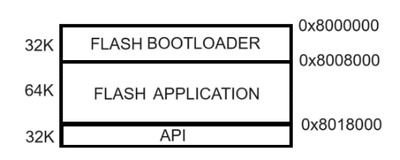

When i comes to memory placements, the three different programs are divided as follows:
The bootloader contains a simple check that ensures an existing application is present before jumping. In case it does, another condition such as pressing the user button will allow the program to jump to the application address.
The application runs the main program, a simple code that will blink the LED. The API section allows the sharing of functions between both the bootloader and the application.
There are two key elements that we need to be aware of when doing this approach.
The first key element being flash page size. We need to make sure we aren’t in the middle of a page when allocating the initial position of the application or shared API. The page size will be different depending on the STM32 used. For the selected NUCLEO-G071RB, all pages have the same fixed size of 2 KB. For more information on any specific STM32, check the flash section in the reference manual.

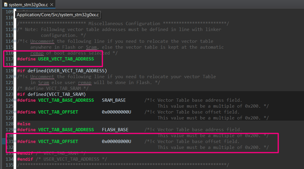

The second key element being the interrupt vector table. The interrupt vector table needs to be remapped as the bootloader and application will typically have independent interrupt schemes and needs.
The vector table base offset field must be a multiple of 0x200 and should be aligned at the beginning of a flash page. It’s worth noting that Cortex® M0, such as the STM32F0 series, doesn’t have this capability, so the developer should consider either sharing or moving the NVIC to RAM. For all other cores, such as M0+, M3, M4, M33, and M7, relocating NVIC is possible and straightforward.

To change the NVIC’s location, go to the [Project Explorer] tab. Inside the [Core] folder, open the [Src] folder, and locate the [system_stm32g0xx.c]. Uncomment the #define USER_VECT_TAB_ADDRESS and change the #define VECT_TAB_OFFSET from 0x00000000U to 0x8000U, as illustrated:

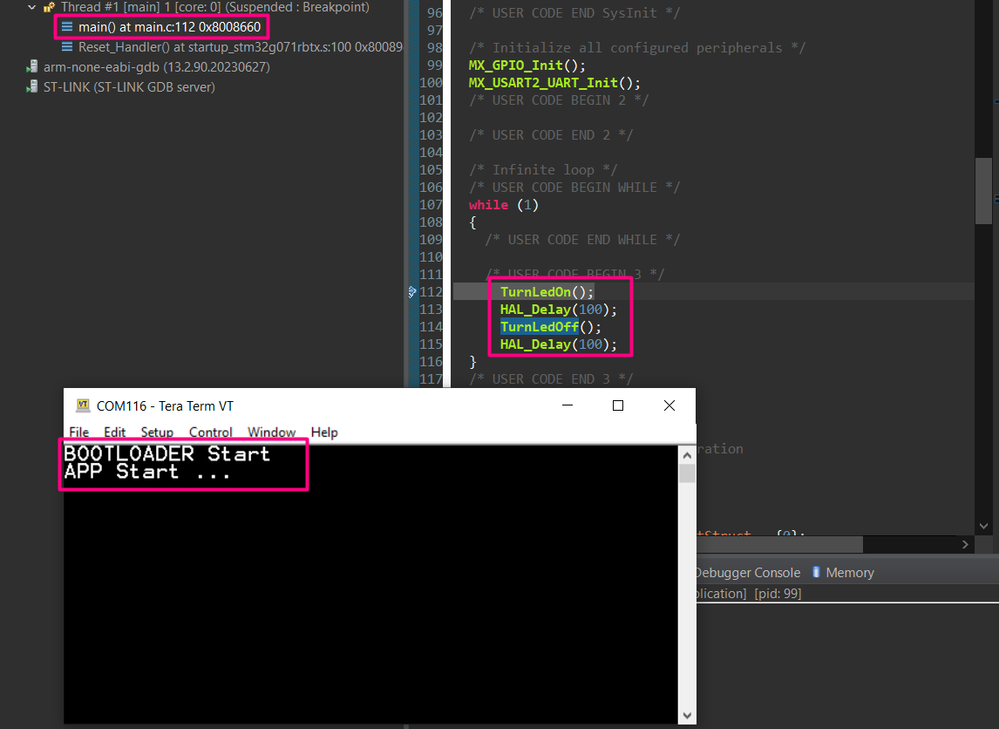

Just to test that both projects can coexist and it's possible to debug, let’s add a simple LED toggle in the applications main loop. Two functions are created for that as they’ll be moved to the API shared region later:

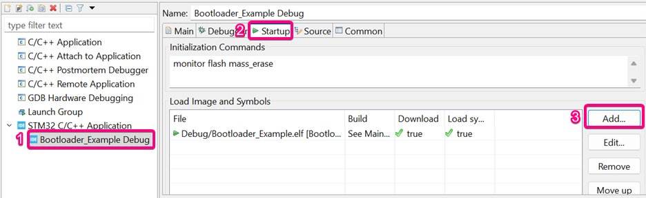

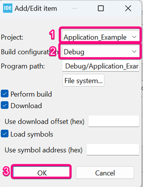

Finally, some configurations are necessary to download both projects inside the STM32. First, access [Debug Configurations] in the bootloader application.
Inside [Debug Configurations], go into the [Startup] tab then click in [Add], select the project to be the application created and click [OK], finally apply modifications.
With the configurations in place, every time the bootloader project is debugged, the code from the application is also downloaded inside the STM32.
Now, when testing, you should be able to see in the terminal that the bootloader has jumped into the application and the LED should be blinking. The screenshot displays the terminal message and a breakpoint is placed in the applications main.c file:

To create the API region in the STM32 memory following the size and memory origin from the introduction, we’ll have to repeat the same process in both existing projects. This means the application and bootloader, unless stated otherwise.
Open the linker script file [STM32G071RBTX_FLASH.ld], locate the MEMORY section and insert a new region called API, between parenthesis type rx. This means that memory from API is only read or executed while the application is running. Add the starting memory address as 0x8018000 and a length of 32K.
Bootloader:
MEMORY
 RAM (xrw) : ORIGIN = 0x20000000, LENGTH = 36K
 FLASH (rx) : ORIGIN = 0x8000000, LENGTH = 96K
 API (rx) : ORIGIN = 0x8018000, LENGTH = 32K
Application:
MEMORY
 FLASH (rx) : ORIGIN = 0x8008000, LENGTH = 64K

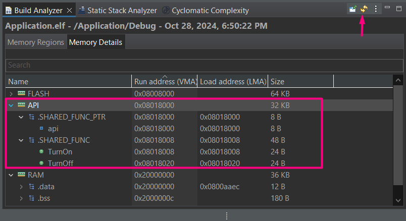

Press [Ctrl + B] to build the projects. There should be no errors or warnings. You can click on the [Refresh] icon in the [Build Analyzer] tab and then expand the [Memory Details] to see the [API] section and usage. The memory used will be either 0 or a few bytes, depending on where the API is created from. In this example, since it was created in the application project, it's displayed there:
To debug, enter using the bootloader project, same as done earlier. You should see the LED blinking before making the jump at a lower pace and then the jump to the application, where it blinks at a higher frequency.
