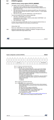

Can you expand on when we need to "remap by hand before making the jump, so SYSCFG->MEMRMP = 0x01" and why this is needed?

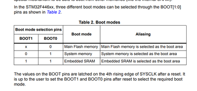

APrim.2
Hello all,
I'm using the STM32F446RE  nucleo board with STM32CubeIde and I would like to use the system bootloader by calling it from within the software.
I implemented the code here suggested by some of you but it doesn't work.
When the code reach the function to jump to the bootloader (BOOTVTAB->Reset_Handler();), the jump doesn't happen but only a reset and the same code that called the bootloader (not the bootloader code) is executed.
Moreover, the DFU device is not enumerated by the PC and the related DFU driver isn't loaded by the PC (when I force the board by the BOOT pin to VCC and reset it all works perfect).
I tried several things also with or without initializing the USB, but nothing worked for me.

    // REMAP
    SYSCFG->MEMRMP = 0x01;

EThom.3
Senior
@APrim.2
I would find it interesting to see how the compiler interprets this line:
I don't think that it does what you expect it to do, even though that part of your code seems to be similar to the example from @gbm .

APrim.2
@Lavanya1
on the STM32F446RE the boot0 pin is not shared with some port pin so I think there is not the possibility to enable the internal pull up.at least I did not found it, I searched also on the graphical configuration tool but there isn't any possibility to enable the boot0 pull up.
Lavanya1
@APrim.2
Refer RM-0390 section 8.2.1. Using SYSCFG_MEMRMP register you can boot from desired memory location.
EThom.3
Senior
@Lavanya1
Yeah, that's exactly what @APrim.2 is trying to do.
// REMAP SYSCFG->MEMRMP = 0x01; // Re-enable all interrupts __enable_irq(); // Set the MSP __set_MSP(BOOTVTAB->Initial_SP); // Jump to app firmware BOOTVTAB->Reset_Handler(); }
 Could it be a problem with the order of events? The manual is more than a little vague on this.
