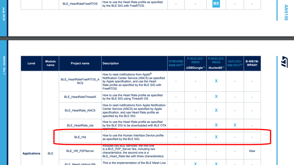

Go to the Product Page for each board, and look on the 'Tools and Software' tab; eg,
https://www.st.com/en/evaluation-tools/nucleo-wb15cc.html#tools-software
There you will see an STM32Cube Package; eg, in this case, STM32CubeWB:
https://www.st.com/en/embedded-software/stm32cubewb.html#documentation
There you can see the Application Note AN5155 describes the available examples - HID is what you'd use for mouse, keyboard, etc:
