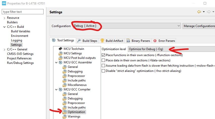

The first issue seems to be in the program size for the M0+. With the default project configuration, the binary for this core ends up taking overflowing its 128k allocated ROM by 7360bytes. I am able to correct for this by either turning on any degree of compiler optimization, or by adjusting the ROM regions defined in the linker script for the M4 and M0+ cores to give the M0+ more space.

It's possible to debug if "Release" but you may face weird behavior from time to time doing stepping. "Release" or "Debug" variation is only compiler optimization. If compiler optimizes some piece of code you may get no chance to break at a given line or to step to because optimized.
If moving from "Debug" to "Release" is leading to build success menas your project is ok already what's good. Then back to "Debug" up to you to select proper optimization allwing you best tradeof (memory footprint / debug experience). Have a try to set -Og ...
‎2021-05-09 10:15 AM
This approach solved my compile problem. Thank you for your help
