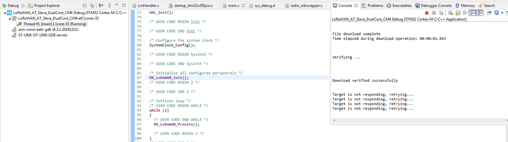

After implementing either of the above changes to allow the build to complete, I set up a debug configuration flash both images and attach the debugger in the M4's context.
The binaries both seem to download successfully, however running the program returns the following error over the device's UART:
 WARNING: There is a difference between the MAPPING_TABLE placement in memory: 0x20008000
 and the address calculated according to the IPCCDBA option byte: 0x2003FFF0
 The execution enters now in a while(1){}
 please check the CM4\MbMux\mbmuxif_sys.c or update the scatter file

mromani2
You are wright, I increased ROM size in M0+ and M4 liker files and now can download both firmware's. I still get a warning about the MAPPING_TABLE placement
I have read in the documentation that I can bypass the while{1} loop and the MCU will reset with the correct values but I wan't to understand the other solution. Is the scatter file the same as the linker option file (STM32WL55JCIX_FLASH.ld)?

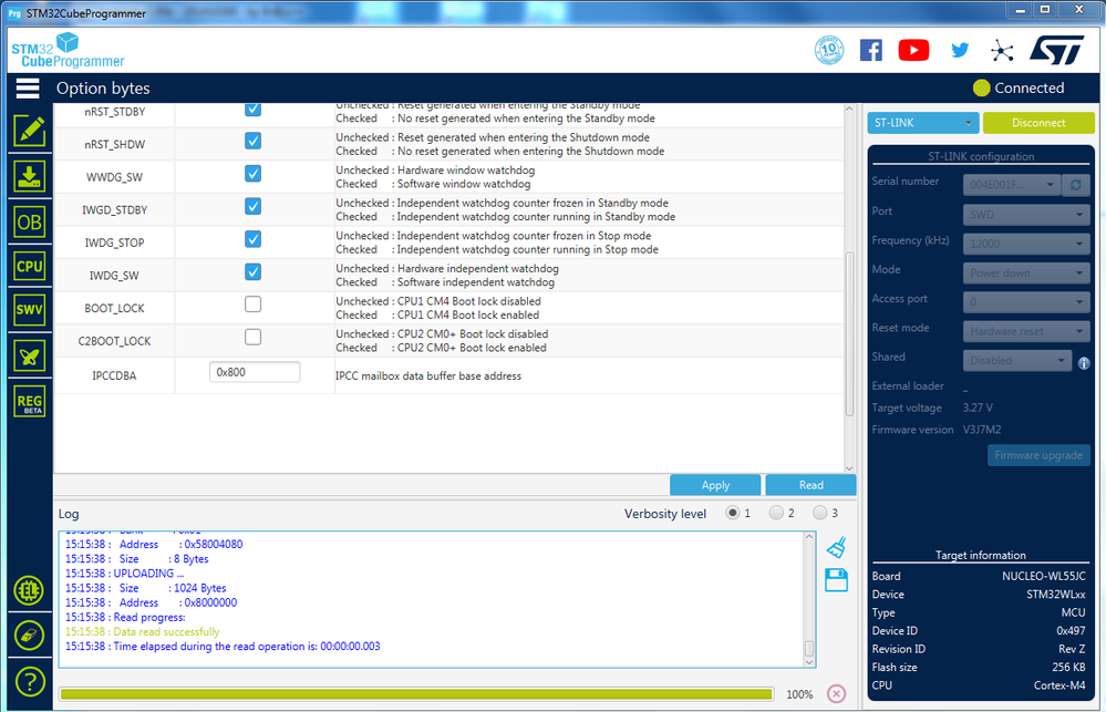

YBOUV.1
For your info, this issue was resolve in https://community.st.com/s/question/0D73W000000W0iv/detail?s1oid=00Db0000000YtG6&s1nid=0DB0X000000DYbd&emkind=chatterCommentNotification&emvtk=WQSlx9RbS.WX4amZMSYIWDVX6a1d0Pou.2dkRalTl4s%3D&s1uid=0053W000001iIzj&emtm=1611692464197&fromEmail=1&s1ext=0
The option byte IPCCDBA probably does not match MAPPING_TABLE address in the linker file at STM32CubeIDE\CM4\STM32WL55JCIX_FLASH.ld.
  • MAPPING_TABLE is mapped at RAM_SHARED (@0x20008000). Mapping table is used to exchange data between the cores.
  • To see IPCCDBA, connect with cube programmer, open tab 'OB', section 'User Configuration', scrolling down to bottom you will find it.
following rule shall apply IPCCDBA = (MAPPING_TABLE>>4)
please try to program manually option byte IPCCDBA to 0x800. The board will restart to reload the new OB value.
This will be automatically done by the FW in next release,
OSTEP.1
Even after modifying manually the IPCCDBA in stm32cubeprogrammer, I have the same issue in cubeide.
