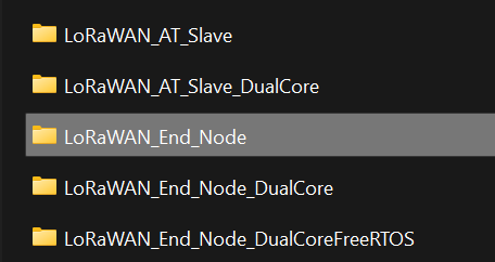

Currently, I'm working on STM32WLE5JC with the LoRaWAN end node example,
I have referred to the following GitHub source. First of all, I'm new to this board & a beginner level in communication protocol so called LoRaWAN
Referred link,
https://github.com/STMicroelectronics/STM32CubeWL
Referred flash program from examples folder,
In this, I'm able to write/read the values in the flash memory using cubemx platform(which stores two uint32_t type variables)!
But when I'm trying the same implementation in LoRaWAN end node example code, facing an issue like "Error in write operation"
I just need to store the values in the memory using LoRaWAN end node example code! (I have attached the functions that i used in the above chain!)
Can you please help with this?
