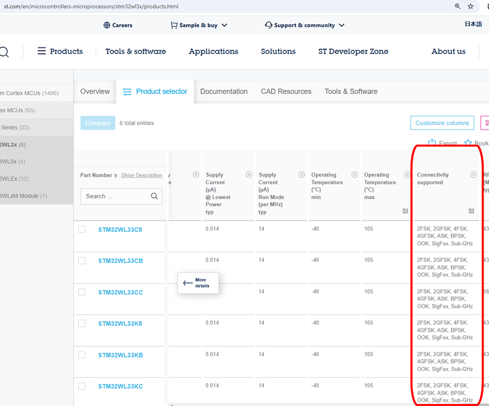

Look at the 'Connectivity' column in the Product Selector:
https://www.st.com/en/microcontrollers-microprocessors/stm32wl3x/products.html

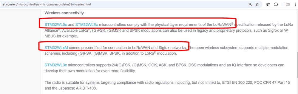

As the name suggests, you need LoRa to do LoRaWAN
See also:
https://www.st.com/en/microcontrollers-microprocessors/stm32wl-series.html
