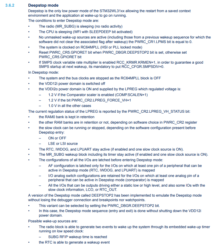

Hello @sbelcatronic ,
Make sure that all configuration steps and conditions mentioned in the Datasheet (page 14 - section: 3.6.2 Deepstop mode) are followed:
  • The radio (MR_SUBG) and CPU are sleeping (WFI with SLEEPDEEP bit set).
  • No unmasked wake-up sources are active (PWRC_CR1.LPMS = 0).
  • The system is clocked on RC64MPLL (HSI or PLL locked mode).
Thanks

sbelcatronic
Thank you Imen.d
I checked all the points.
1-' the radio (MR_SUBGHz) is sleeping' :  I do not configure the MR_SUBGHz, so it is in sleep.
2-' The CPU is sleeping (WFI with SLEEPDEEP bit activated)' : I call the function HAL_PWR_EnterDEEPSTOPMode(); so it set proply the bits.
3-' No unmasked wake-up sources are active (including those from a previous wakeup sequence for which the software did not clear the associated flag after wakeup) the PWRC_CR1.LPMS bit is equal to 0': again I call the function HAL_PWR_EnterDEEPSTOPMode() and this do the calls:
  /* Clear all the wake-up pin flags */
  LL_PWR_ClearInternalWakeupSource(LL_PWR_WAKEUP_ALL);
  LL_PWR_ClearWakeupSource(PWR_WAKEUP_PORTA, LL_PWR_WAKEUP_ALL);
  LL_PWR_ClearWakeupSource(PWR_WAKEUP_PORTB, LL_PWR_WAKEUP_ALL);
4-'The system is clocked on RC64MPLL (HSI or PLL locked mode)' : My SystemClock_Config() is
void SystemClock_Config(void)
  RCC_OscInitStruct.OscillatorType = RCC_OSCILLATORTYPE_HSI;
    Error_Handler();
  /** Configure the SYSCLKSource and SYSCLKDivider
  RCC_ClkInitStruct.SYSCLKSource = RCC_SYSCLKSOURCE_HSI;
  RCC_ClkInitStruct.SYSCLKDivider = RCC_RC64MPLL_DIV1;
  if (HAL_RCC_ClockConfig(&RCC_ClkInitStruct, FLASH_WAIT_STATES_1) != HAL_OK)
    Error_Handler();
 I use HSI clock source as required.
5-' Reset PWRC_CR5.GPIORET bit when PWRC_DBGR.DEEPSTOP2 bit is set, otherwise set PWRC_CR5.GPIORET bit':
the flag PWRC_CR5.GPIORET do not exist (I guess is a datasheet error) but I set the bit  PWRC_CR2.GPIORET by adding the function call HAL_PWREx_EnableGPIORetention(); before enter deep stop.
I think I have respected all the requirement in 3.6.2, but the problem still.
Thank
I forgot the last point:
5-' If SMPS clock variable rate multiplier is enabled RCC_KRMR.KRMEN=1 (see SMPS clock variable rate multiplier register (RCC_KRMR)), in order to guarantee a good SMPS startup at next wakeup, its mandatory to put RCC_CFGR.SMPSDIV=0 ':
I verified by the debugger the flag RCC_KRMR.KRMEN=0 so the clear the flag RCC_CFGR.SMPSDIV=0 is not mandatory.
