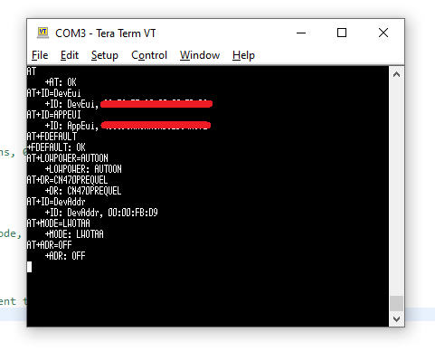

I have a P-NUCLEO-LRWAN3 and I have downloaded the I-CUBE-LRWAN expansion software.
Using the project "STM32CubeExpansion_LRWAN_V2.1.0 \ Projects \ NUCLEO-L073RZ \ Applications \ LoRaWAN \ LoRaWAN_AT_Master \ STM32CubeIDE \ LRWAN_NS1" and following the procedure indicated on the file "readme.txt" on the VCOM port I cannot send and receive anything. I also tried to use the "LoRaWAN_End_Node / STM32CubeIDE" project but there is no project related to my SX1278 model. Instead the Gateway works perfectly. I've read all the existing documentation but can't get it to work. What i can do?
Thanks
Edit: by enabling DEBUGGER_ON in "sysconf.h" I can see this but I can't send AT commands0693W00000FA96cQAD.png

Ok, I was able by reading the source codes to set it up correctly.

For some reason The LRWAN_NS1 app crashes ("not responding, not responding...") when calling function DBG_Init(), whatever DEBUGGER_ON value is previously set (0 or 1).
Hack/solution that works: comment out DBG_Init() in file Core/Src/sys_app.c. You should see the AT command logs again on you terminal. But configuring them (freq region, for instance), as already observed by many, still doesn't work by sending AT commands from then terminal.
Rather than that, manually changing the the values in LoRaWan/master_app.c also do the trick.
