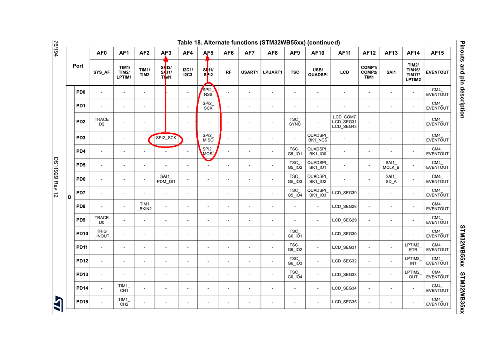

STM32WB55RGV6 connects ADS1299 by spi. And I choose spi2. There are three signas miso\ mosi and sck. SPI2 has two alternative: GPIO_AF3_SP2 and GPIO_AF5_SPI2.
① STM32CUBEMX automatically generated miso(GPIO_AF3_SP2), mosi and sck(GPIO_AF5_SPI2).Initialization is ok, but no data.
② All ​GPIO_AF3_SP2. Initialization is failed and application crash.
③​ All ​GPIO_AF5_SP2. Successfully.
Although the result is good, I do not understand why:sad_but_relieved_face:
waclawek.jan
Which pins?
Look at the Alternate functions table in the datasheet to determine, which AF number to use for each pin.

Thank you,I found the error,SCK(PD1), GPIO_AF5_SPI2.
