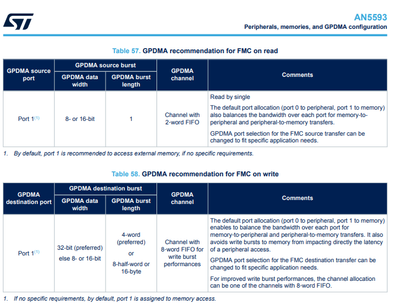

We're experiencing memory overflow errors when trying to use external PSRAM (IS66WVE4M16EALL-70BLI) with GPDMA for real-time audio capture on STM32H562AII6. Despite having 8MB external PSRAM, our audio buffers cannot be placed there due to DMA timing/access issues.

We need guidance on whether external PSRAM via FMC is suitable for real-time GPDMA applications on STM32H562, and if so, what the optimal configuration should be. If not, recommendations for alternative approaches would be greatly appreciated.
Any insights into proper FMC timing, cache management, or alternative memory solutions for large audio buffers would help resolve this critical memory constraint in our real-time audio system.

Hello @Vaishak-hoomanely ;
First of all I apologize for my late reply.
Ensure that you have respected the GPDMA recommendations for FMC shared in AN5593 "How to use the GPDMA for STM32 MCUs".
Thank you.
