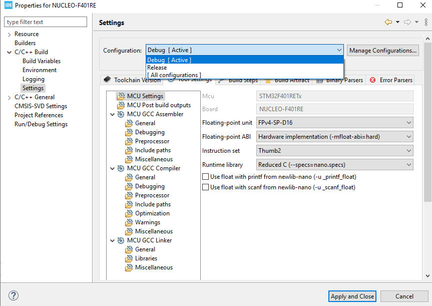

Ohh. Thanks for showing it. I see both Release and a Debug build configuration as in screenshot.
What to do next?
Thanks.
EJOHA
Senior
OK! It seems fine and Debug configuration is the active one.
If it does not work to debug the application the reason could be that the application is located above 0x8000000 and it is intended to be started by a bootloader.
To see what happens when debugging if it does not break at main you can in the Debug Configuration open the Startup tab and deselect the "Resume" checkbox. This should make debugging start from the Reset_Handler in the startup file. Step through and see what happens.
I have not debugged the OTA projects and do not know the Bootloader. Maybe the Bootloader updates the vector base register when it is used. In that case you need to set vector base register instead in the application to make interrupt work correctly. I really hope there are some documentation/readme file together with the applications you are testing.

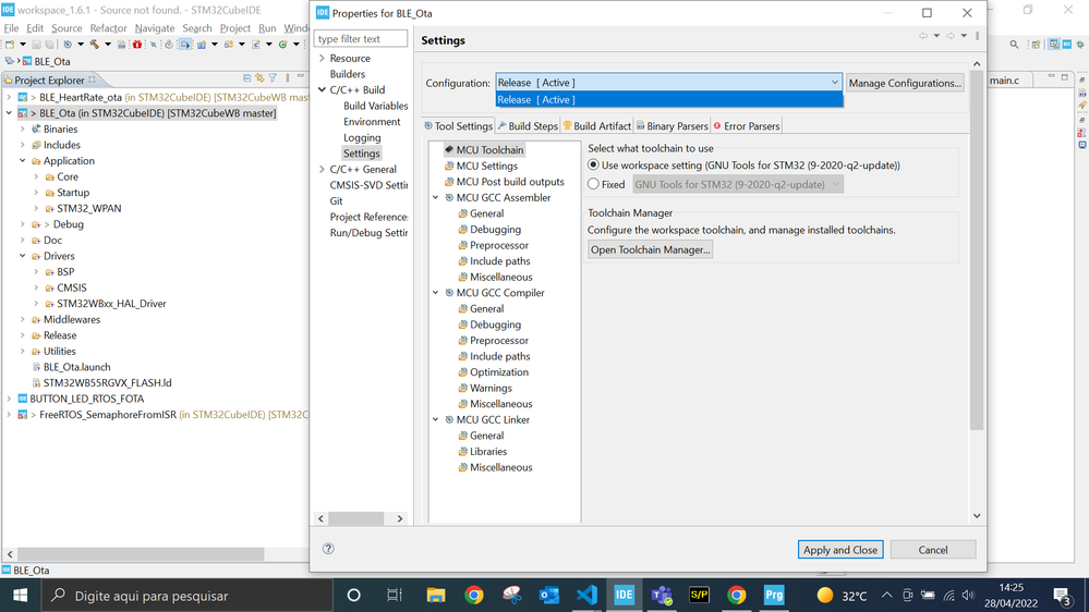

Hi EJOHA.
I can't debug the BLE_OTA project, I noticed that there is no build option for debug, how do I get the project to be built in the debug version?

Nikolaj_TL
I am facing the same issue, when debugging the application BLE_ota (for STM32WB55) I get the same error as previously mentioned.
No 'DEBUG' version is available from the example project only the 'RELEASE' version.
I have been following the example from: STM32WB Getting Started Series: Part 7, Over-the-Air (OTA), and have read the application note on Dual-Core Debuggning from AN4989 and AN5361, but without any help.
Can anybody help resolve the issue, for me to be able to debug the code as shown in the video mentioned above?
Nikolaj_TL
Problem resolved by setting up of Debug Build Mode
Steps:
- Make a new Build mode based on Release (only one excisting)
Build Configuration > Manage > New
- Properties > C/C+ Build > Settings > MCU GCC Compiler > Optimization
Optimization level: Optimize for Debug (-Og)
- [...] > MCU GCC Compiler > Debugging
Debug level: Maximum (-g3)
- [...] > MCU GCC Assembler > Debugging
