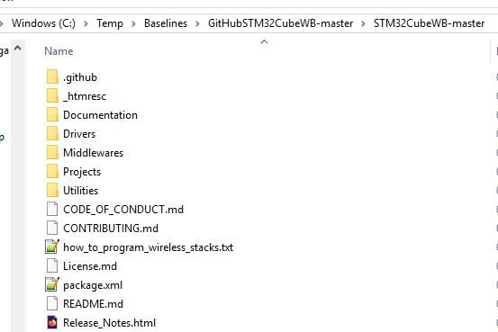

Hi @ashkanr65​
Did you downloaded the full WB FW package i.e. https://github.com/STMicroelectronics/STM32CubeWB ?
(and not only starting from the project itself).
In order to compile properly, project refers to files that are outside Projects/P-NUCLEO-WB55.Nucleo directory.
You should have similar tree structure in the directory where you cloned the WB package :
Errors in IAR indicates something is wrong in your environment (files not where they are expected to be according to all relative paths used in project).
Guenael

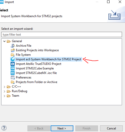

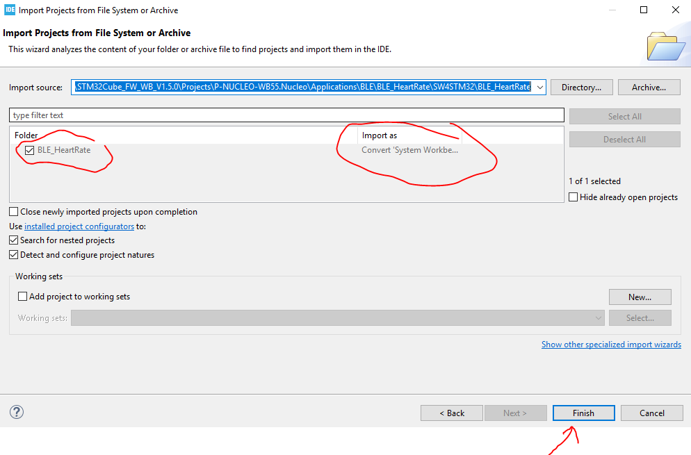

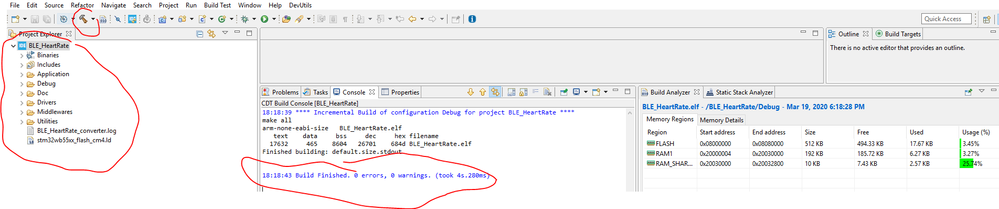

What's a bad advice to rely on SW4STM32 ... such is almost deprecated, not more improved, ... Please rely on STM32CubeIDE which is ST supported, new generation IDE etc. ...
Even if only SW4STM32 examples available for some device(s) STM32CubeIDE is fully supporting SW4STM32 projects.
Please enjoy your WB BLE example ... only requires 3 steps ...
1) File > Import
2) Point to your example path (up to SW4STM32/<project name> segments)
3) Press finish & you're done being able to build the project
