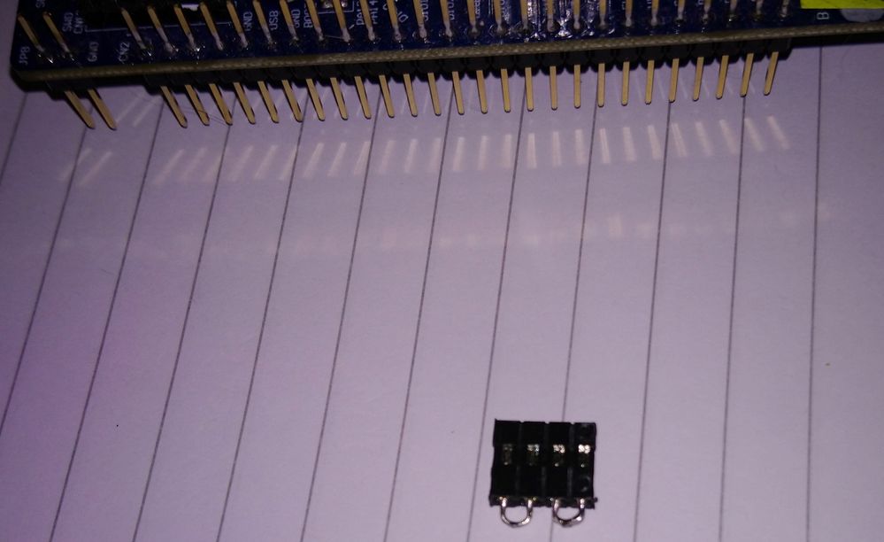

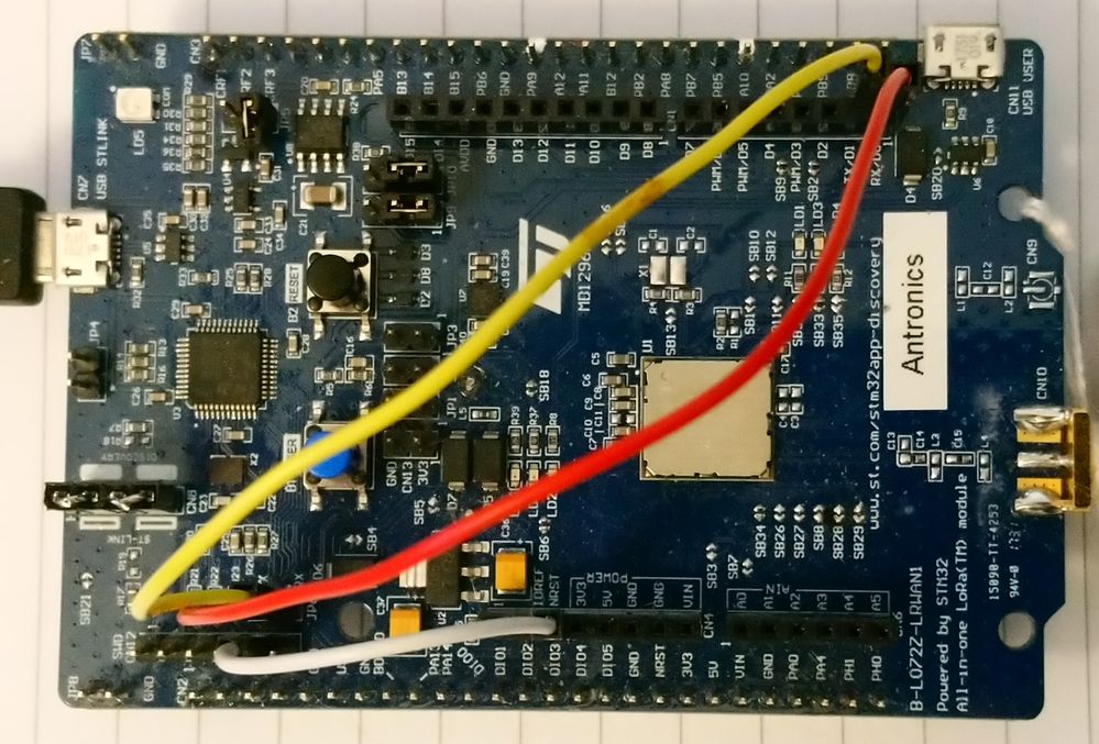

To be able to use the onboard ST-Link again, these connections need to be restored:
  • NRST: link CN4.3 to CN12.5;
  • SWD: fit two links on CN8;
  • VCOM: link CN5.1,2 to JP6.
Rather than have to mess about with 2 separate links for the SWD, a single-row 4-pin header can be adapted:
