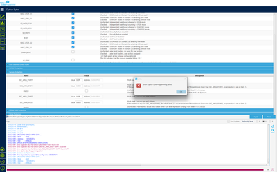

Hello Jocelyn,
I did now tried to set the secure protection bits, which does not work via CubeProgrammer v2.15 and v2.10.
_________________________________________________________________________
CubeProgrammer v2.15:
- SECURITY bit is set
- SEC_AREA_START1 to 0x000
- SEC_AREA_START1 to 0xfff (same values to protect whole bank tested as well)
-DMES1 checked
-> no popup window
-> progress indicator does not stop (even after minutes)
-> output log on verbosity lvl 3 shows nothing
-> read the option bytes stops the indicator and reads the default setting
CubeProgrammer v2.10:
-DMES1 checked
->  popup windows with warnings that we can do serious damage
-> Error: Option Byte Programming failed
-> see attached screenshot with log (Secure Protection level settings were set and now reset with the error pop up)

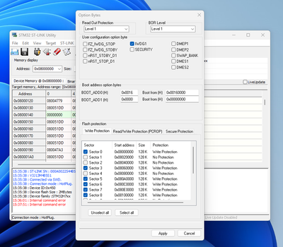

st-link utility tool v4.6.0.0
-> "Internal command error" while opening the option bytes menu
-> It seems to read the correct values (security byte is set), but I did not tried to write the option bytes because of the internal error 
Do you have any idea what causes this kind of error?
Something0815
Finally it worked after serveral retries with CubeProrgammer v2.10. Thanks for your help!
