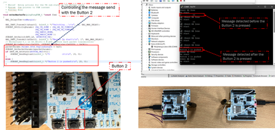

I used the pingpong sample code with the tutorial I have found in the TechForum: Link of the tutorial in order to establish the radio frequency communication between two Nucleo-WL55JC2 boards and it works.

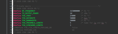

 And then I tried to communicate with the device that has this configuration

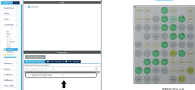

It didn't work with my code, I searched for the problem and I found on the configuration of the subghz: 

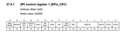

What is the role of the baudrate prescaler value for the subghz configuration?
and what changes should I make?

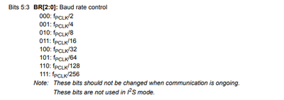

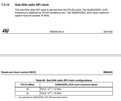

According to the RM0453, The sub-GHz radio SPI clock is derived from the PCLK3 clock. The SUBGHZSPI_SCK
frequency is obtained by PCLK3 divided by two. The SUBGHZSPI_SCK clock maximum
speed must not exceed 16 MHz. So, the  baudrate prescaler value should be 4 or more in case PCLK3 clock is 48MHz or 2 in case PCLK3 clock is 32MHz.
So, the baudrate prescaler value is the frequency divider value. it set exactly the 3 bits of the Baud rate control on the SUBGHZSPI_CR1:

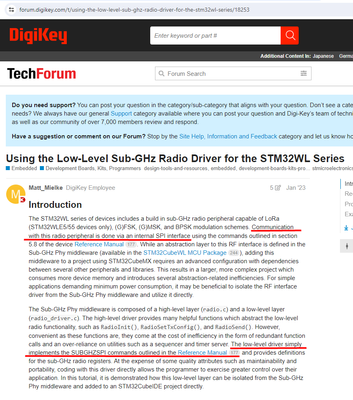

That's DigiKey's forum - nothing to do with ST.
https://forum.digikey.com/t/using-the-low-level-sub-ghz-radio-driver-for-the-stm32wl-series/18253/11
As it says there, they're throwing away ST's standard code, and doing something "different" instead - so you'd probably be better asking the actual author there what it is that he's done, and how to understand & use his code!
