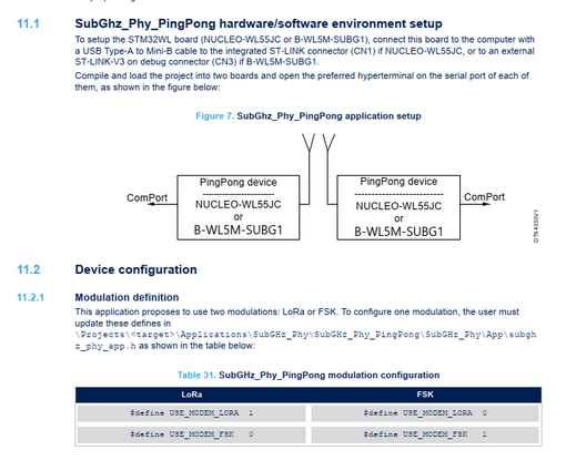

It works as a ping pong application -you can find a better description about this application in this link page 44- after that I tried by developing the same code of the ping pong application to communicate a nucleo-32wl55jc1 with nucleo-32wl55jc2 because in the datasheet they don't use the same frequency but it works!

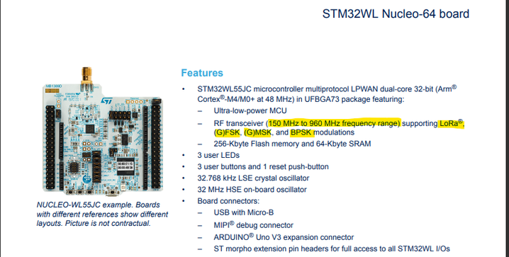

My first question is if the NUCLEO-WL55JC cards are able to read RF signals from these RF devices?
The second one is if the code of the PING PONG application forces me to use only NUCLEO-WL55JC boards or B-WL5M-SUBG1 device?
For example, if I change the RF configuration to match the configuration of the RF device.

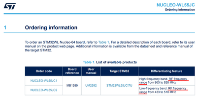

And, what is the meaning of the RF range specified in the data sheet of the NUCLEO-WL55JC boards?

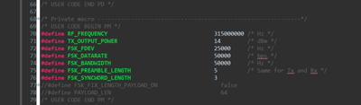

Finally, I tried to communicate with the device that has this configuration
Are these variables the only ones used in the RF configuration? if not, I would appreciate it if you could specify the critical variables that I need to identify in order to program the NUCLEO-WL55JC boards for effective communication.

The STM32WL is a Sub-GHz module that can communicate with any device that use the Same Modulation, same Frequency, ...
The Ping Pong application can be configured to fit on any Wireless STM32 MCU or module. You just have to take care of the HW differences on migration.
RF range is the range of frequency that each MCU can use for communication.
The Sub-GHz parameters are all mentioned on the .h files of the SubGHz_phy folder of each Sub-GHz project (Ping Pong for example).
It's certainly not the type of thing that the WL are really targetting.
To answer that, you're going to need to find the specifications for those "RF devices" - in particular,
  • On what frequency they operate
  • What modulation they use
  • What protocol they use over the link.
I think ST provides the Ping-Pong example for all of its LoRa-based products - so no, it's not restricted to just WL
However, car & garage door openers tend to be unidirectional - so they certainly won't do a Ping-Pong.
And they don't do LoRa.
It actually says, "RF frequency range":
https://www.st.com/resource/en/data_brief/nucleo-wl55jc.pdf
so that's the range of frequencies (from lowest to highest) at which it works.
Not to be confused with "range" in the sense of the distance over which it can communicate!

Yes, I have developed two projects with STM32F407 DISC1 and one with STM32f429I-DSICO as ST products, two different types of the Raspberry and the ESP32 in many project in different domain; AI, image processing, Robotics... and I worked in high school with the Arduino. I am still considered as a beginner, but I have an experience to understand some technical details and these are my first steps in RF Domain
You are right, the WL series are targeting the LoRa WAN communication protocol, in fact, they are also able to communicate with the RF devices with RF range from 150 MHz to 960 MHz supporting (G)FSK, (G)MSK, or BPSK modulations.

Hello @STTwo-32
Thanks for the detailed explanation! It clarifies the concept of Sub-GHz communication and modifying the ping pong application.
Here's my understanding:
  • The ping pong application can be adapted to various Sub-GHz projects using compatible STM32 MCUs or modules.
  • Hardware differences might require adjustments during migration.
  • Sub-GHz parameters are defined in the .h files of the SubGHz_phy folder for each project (e.g., ping pong application).

yes, I understand that and I mean by no protocol is that a simple protocol of a RF communication.
@Andrew Neil wrote:
No: the supplied application uses LoRa, and those devices don't.
I could you please approve that the pingpong application uses just LoRa, because in the one of the application note I found this (LoRa and FSK: frequency shift keying) in the page 44.
OK - so it looks like that can be configured to just plain FSK modulation, then.
But all that tells you is that Frequency-Shift Keying is applied to the carrier - to communicate with another device, you'd also need to know what deviation is used, what kind of modulating signal is used (eg, Manchester), what the modulation rate is, what the precise carrier frequency is, etc, etc ...
All of these form part of the communication "protocol"
