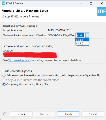

I have to use WBA52. Can you suggest last working combination of CubeIDE and FW version. Should CubeIDE 1.13.2 and FW 1.1.1 work?
From FW 1.2.0 and CubeIDE 1.14.0 there is an "Improved" BLE code generator - more options, multirole etc. This will be never available for the WBA52?
To be able to program you STM32WB52 Nucleo board, you should use the V1.1.0 of the STM32CubeWBA (with any version of the CubeIDE but it is always better to use the latest).
Best Regards.
STTwo-32
cvs_dk
ok, but in the newest CubeIDE I can only select FW 1.4.0 or 1.4.1.
Sorry for this mistake. you have to use an older version of the IDE/MX
Best Regards
