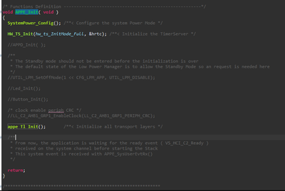

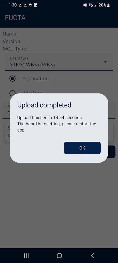

I have a custom board which is based heavily on the P-NUCLEO-WB55.Nucleo.  If I flash my board with a slightly modified version of BLE_Ota it will appear in ST BLE Sensor, at which point I can use it to flash my application.  This works.  After flashing the board will reboot and my application will run.

As a result, it shows up in ST BLE Sensor still and allows me to do a FUOTA update.  However, if I try and upload the exact same file again the board will reset but the firmware update will fail (never goes beyond 0%).

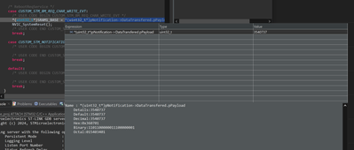

I can debug my design and set a breakpoint for when ST BLE Sensor reboots it:
I am able to trace the execution all the way through the reset and back into the BLE_Ota code.  I can see that the code is running, its stuck forever waiting for SHCI_C2_BLE_Init() to finish.  At that point I have to power cycle the board and it will return to my code.

Commenting these lines appears to have fixed the problem.  These lines do not appear in Cube-generated code.
