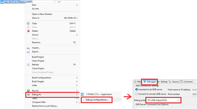

Hello @Dobry ,
It seems that this was a known limitation and the workaround is to use ST-LINK (OpenOCD) option.
So in your project, change the Debug probe config from ST-LINK GDB server to ST-LINK OpenOCD setting:
Normally it should work .. I tested it. 
Home that helps.

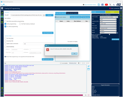

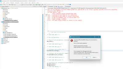

Hello mƎALLEm,
Thank you for these suggestions, but unfortunately these still does not resolving my connection problems.
I already did a lot of experiments with different debbuger options and ports, including test with different configuration scripts, but I am still unable to connect to NUCLEO-WL33CC boards.
When trying to connect in Cube IDE environment I am getting the following error message:

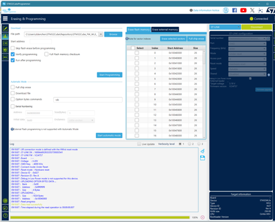

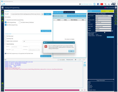

 ... so I tried again with the STM32Programmer tool... again without success. In Programmer tool there are no debug options, to choose, but it is clearly visible that the embedded ST_LINK V3 is unable to connect to the tartget. I am not sure is this meanigfull, but on every next attmpt to connect, the error messages alters:
In the same time, with my custom made board and ST_LINK V2 I am able to connect with STM32_Programmer and to flash my executable. The same still does not work with CubeIDE, but if I disable code download, I am able to start debug session with GDB and to trace the code flashed with Programmer tools:
