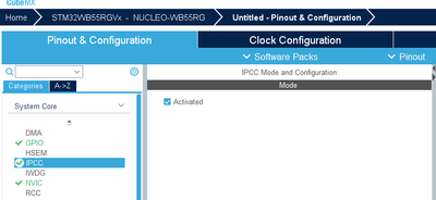

i am a beginner in STM32cube. i was working on board Nucleo wb55rg. and following this tutorial
STM32WB Getting Started Series: Part 12a, STM32CubeMX & STM32CubeIDE lab. Introduction, and it said on 2:33 that i need to activate "system core>IPCC and enable both interrupt". i am using STM32CubeIDE 1.5.0 and it does not show IPCC option on it .

 thank you so much for the help. that was the case. just one correction: earlier i was not using STM32CumeMX, i was using STM32CubeIDE. the issue got fixed when i used STM32CubeMX version 6.8.1. thank you so for your help :)
