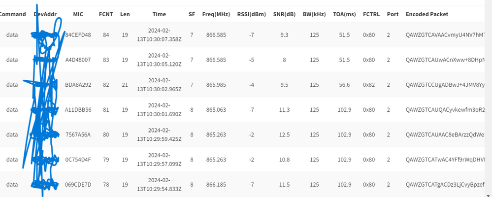

1) In this case I tried filling 6byte and transmit it, at SF7 I'm getting 28 frames per minute=6byte*28frames=168bytes=22.4bps.
2) In this case I tried filling 48bytes and transmitting it, at SF7 I'm getting 27 frames per minute=48byte*27frames=172.8bps.
3) In this case I tried filling 240bytes and transmitting it, at SF7 I'm getting 24 frames per minute=240byte*24frames=768bps. That is also I'm getting frames only at SF7 and SF8 and for the rest of SF I'm getting empty frames. When i try to fill 240 bytes.
As Lorawan is capable of 5kbps. At what conditions and parameters I'll be getting at least 3 or 4kbps of speed?
I'll describe my application: I want a maximum range of 1Km, with a maximum data rate as much as possible, a node has a buffer size of 242 bytes, and as I fill that buffer and send the data it only transmits at SF7 and SF8 and for rest of SF it transmits empty frames even at 50 meters.
All the require parameters are also fine(TOA(ms), RSSI and SF,etc)

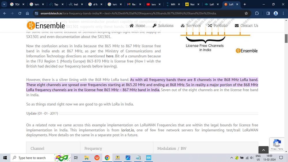

1) You can have either the maximum range or the maximum data rate: I'm Keeping my gateway and node at a 5cm distance then too I'm getting 24 frames at SF7, Which is 768 bps.
2) When it comes to license-free bands: Out of 8 bands, 7 are license-free only. when it comes to license bands. How can I get those license bands?

@Yuvi wrote:How can I get those license bands?
By obtaining the appropriate licence(s) !
That would probably require you setting up as a major network operator.
