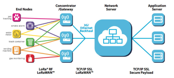

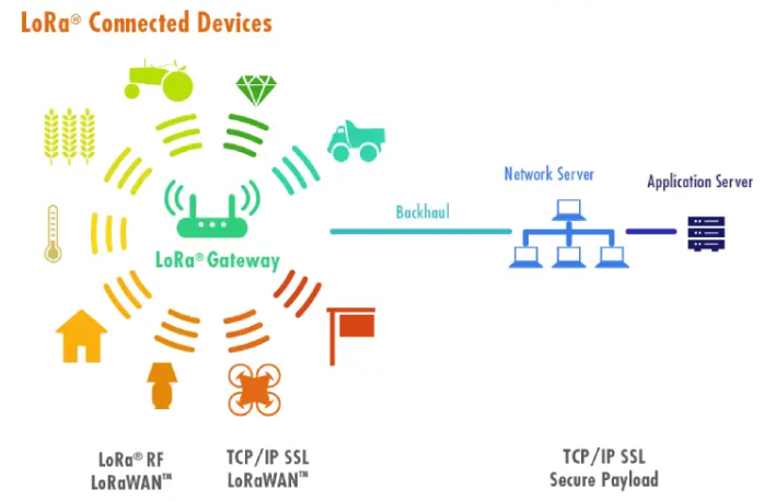

If I understand the image correctly, the “end_node” example code supplied by STM links the card directly to the server via gateways? So we don't need to create gateways ourselves, we just need to be near an existing one?
Now, I'd like several of my cards (NUCLEO-WL55JC) to act as end nodes connected to a single application, and, to start with, one NUCLEO-WL55JC card would be the sensor. Later, why not add sensors?
The aim of having several end nodes is to extend the reach of my system.
I hope I've explained it better ;)
Bests regards
KYZ.
Yes - that's pretty much the definition of a LoRaWAN end-node.
Again, not necessarily "near", just within range - which could be tens of km.
Just like your mobile phone needs to be within range of a cell tower, or a WiFi device needs to be within range of an access point, etc.

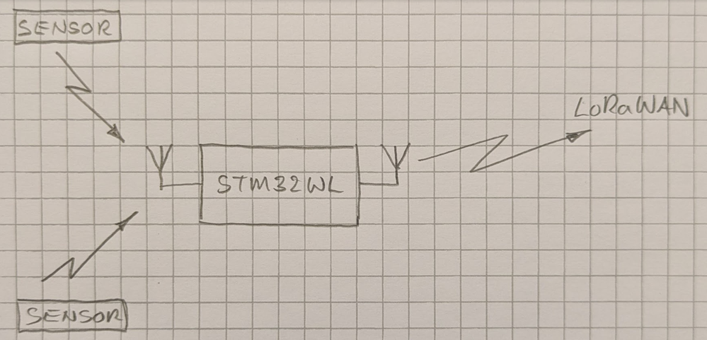

Yes, by “near” I meant “close enough for a connection to be established”. Thanks for clarifying with the phone analogy, I had understood myself, but I hadn't found the right words in my explanation.
Here's an explanatory diagram. I want to do some tracking. We have a single device that can move around and every so many times it communicates with the server (via the gateway(s) with which it's able to establish a connection).
If the device manages to establish a connection with 2 gateways, they must not send data at the same time to avoid collisions. What's more, when the server receives this data, it must be able to see that it's the same data, and so respond to only one gateway, for example.
I hope that's clearer now !LoRaNetwork.jpg!
Sorry, is this a new question?
I'm afraid I don't see how any of this relates to the preceding discussion.
