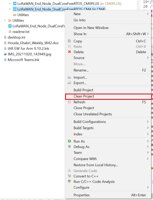

After an export then import (whether in "file system" or "archive file") of a working project, I cannot "build" this project agin after this export/import. While the basic project (before the export and the import i.e. the displacement) works perfectly on the same computer. It looks like there is a link problem.
12:39:41 **** Incremental Build of configuration Debug for project LoRaWAN_End_Node ****
make -j16 all
make: *** No rule to make target 'C:/Utilities/trace/adv_trace/stm32_adv_trace.c', needed by 'Utilities/stm32_adv_trace.o'. Stop.
"make -j16 all" terminated with exit code 2. Build might be incomplete.
12:39:42 Build Failed. 1 errors, 0 warnings. (took 363ms)

Hi @LLr.1​ ,
In order to solve this issue, you just need to clean the project and then rebuild it. Please refer to the attachment.
0693W00000GXPQnQAP.pngRegards,
Sara.
Unfortunately, this also appears right after the clean.
Maybe the reason, it is git in my files ?
Louis
LLr.1
Senior
The bad solution I found, it's to add the cited file in the cited path of folders
