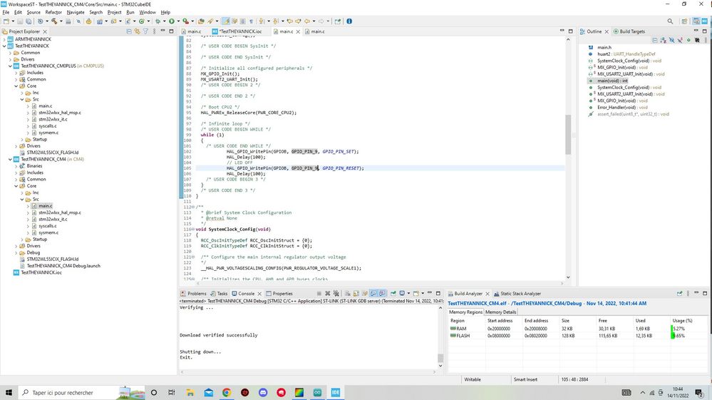

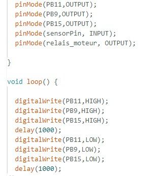

Hello, i just bought a STM32WL55JC2. It's working perfectly on Arduino but i want to use the LORA module and Arduino doesn't support it.
I've configured my stm on CubeMX and tried a basic HAL_GPIO_WritePin but it doesn't work and i can't figure why.
0693W00000WIFX9QAP.jpg0693W00000WIFXiQAP.jpgArduino working code :0693W00000WIFROQA5.jpg0693W00000WIFXdQAP.jpgThank you :)

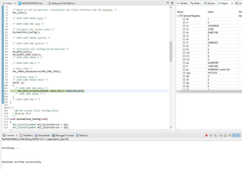

try : debug and you can see the port registers , when you step in your prog.
BNamu.1
BNamu.1Author
November 14, 2022
0693W00000WIHF7QAP.jpg@AScha.3​ I can't figure which register is attached to my LEDs ? Thank you
edit : r1 and r2 have changed for 512 after 1 while loop

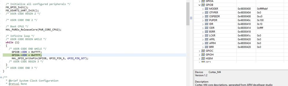

The registers in the GPIOB peripheral, ie GPIO->ODR
And the clocking of the GPIOB via the RCC peripheral

Thank you, where do i check the GPIO->ODR state in the debug mode ?
AScha.3
November 14, 2022
BSRR is write only. so nothing to read!
and ODR shows ffff , what you write in. so whats wrong ??

if my gpiob->ODR shows ffff the led on my board should be turned on right ?
AScha.3
November 14, 2022

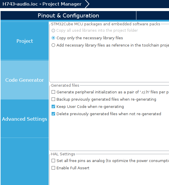

yea, but i see: _MODER shows 0xFFFF... -> pins are on analog mode !!!!! so no hi/lo output.
where you set it analog? check!

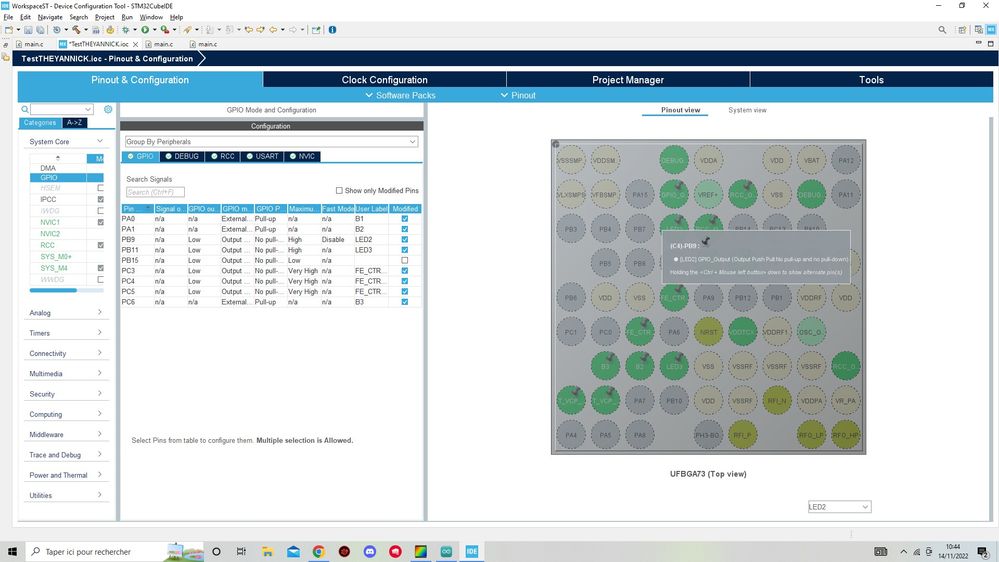

0693W00000WIHuyQAH.jpgi generated the code automatically so i didn't change anything. I don't know how to change this.

check: did you
x set free pins as analog ?
to test : just write
GPIOB->MODER = 0x55555555 ;
while ....set pin .... .

Nop this parameter isn't enable. BUT with GPIOB->MODER = 0x55555555 ; my led is now working !!! Thank youu, i still don't know why my pins are on analog mode but it's fine

ok, not fine , but we got it going.
there is some instruction doing this - or is an error in Cube/HAL , then you should set pins yourself and not trust in HAL . (it has some errors, shure.)
