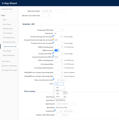

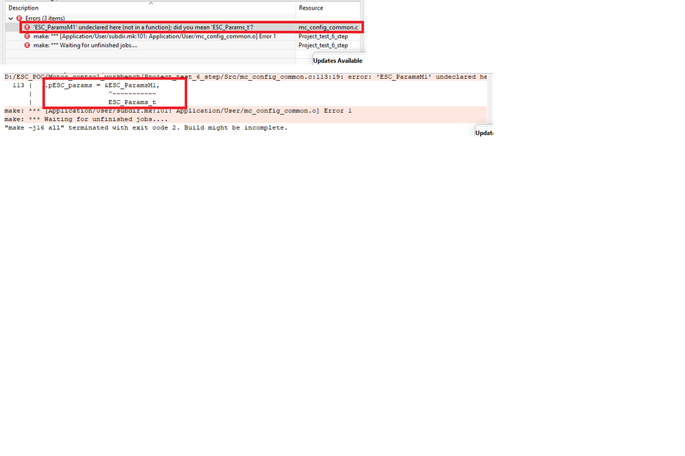

As per your suggestion, we implement 6 step algorithm using MC Workbench 6.3.0. but we are getting the below error, as mentioned in the attached image. we are using B-G431B-ESC1 inverter board from ST Microelectronics.
GMA
April 29, 2025
Hello @Research_Associate,
ESC input uses TIM2. You have to select another timer for the speed sensing config.
If you agree with the answer, please accept it by clicking on 'Best answer'.Best regards.GMA
GMA
April 29, 2025
Which MCSDK version are you using?
With MCSDK6.3.2, I do not have such error.
