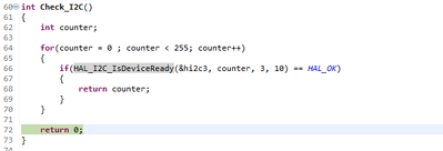

ErrorCode=32 indicates HAL_I2C_ERROR_TIMEOUT.
Devaddress=0 suggests an invalid slave address.
Ensure HAL_I2C_IsDeviceReady returns HAL_OK before using any other HAL_I2C_* command.

I2C doesn't see device:

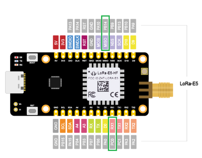

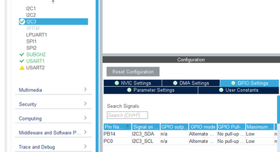

According to the MX configuration, I2C3 has the following GPIO:
According to the WIO Lora E5 Mini wiki, I see that these pins are
PCO => RX1
PB14 => MISO

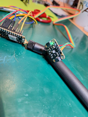

The Green LED on the SI7021 fires.
I checked the connections between LORA and this sensor many times, and all look good.
The ST-LINK V2 is attached to the LORA device too.

That board is clearly labeled with SCL and SDA which is I2C2. So it's PA15 and PB15 that needs to be used.
By default when enabling I2C2, it chooses PA12 for SCL. So you override it and choose PB15 for SCL.

The AdaFruit board has 10K pull-up, and a level shifter. Looks to be built on the assumption of a 5V supply/signalling. Not sure of what the regulator's going to do with 3.3V and both VCC and 3V3 need to be present. The SparkFun board is less encumbered, can find on eBay, Amazon, Mouser, DigiKey.
Enumerating what you've wired to what. Pictures help, but have to decipher colours, and placement
Would expect to need VCC,3V3,SCL,SDA,GND minimum. If providing VCC, check the voltage at 3V3 pin for drop-out

@Karl Yamashita  I choose I2C3, so PC0 and PB14 will the pins to connect.

@TDK  According to the MX documentation for this chip under the STMCubeIDE, these GPIOs (for I2C) don't need any pullups or pulldowns.
I have several sensors attached to the LORA devices without those pulls.
@TDKThis helped me to discover the real cause of my problem. I debugged the code and found that LORA couldn't find the sensor attached to it.
