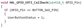

STM32WL: NUCLEO-WL55JC1. Has anyone managed to use user button 2 ?

I tested the board with the UART_TwoBoardPolling but I don't succed to turn the user button 1 into the user button 2. The LED stops blinking but nothing append. With the debugger, it is going somewhere but i don't see where... maybe hardfault ?

First you have to modify the void HAL_GPIO_EXTI_Callback(uint16_t GPIO_Pin) function in the main :
Then you have to add the interrupt handler for the button 2 : void EXTI1_IRQHandler(void) function in the file stm32wlxx_it.c :
Fix the issue on my side, let me know if it works for you.
Regards

Hello, Thank you for your reply.
It works for me.
I was thinking that the interrupt handler for the button 2 : void EXTI1_IRQHandler(void) exists already (maybe you can add it directly in a next version of the CubeWL)
