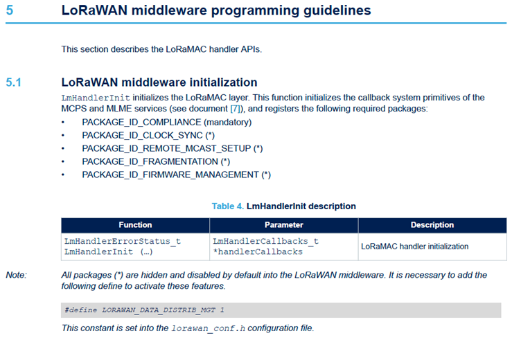

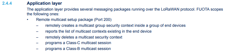

On the device side, you must use the Remote Multicast package that is use when you want to enable a FUOTA session (LmhpRemoteMcastSetup.c).
You have to enable this package by calling the function LmHandlerPackageRegister (PACKAGE_ID_REMOTE_MCAST_SETUP, NULL) define in LmhpPackagesRegistration.c.
This will allow the device to support LoRa MAC commands related to multicast.

For more information, you can refer to this Application Note : AN5554 LoRaWAN® firmware update over the air with STM32CubeWL: https://www.st.com/resource/en/application_note/an5554-lorawan-firmware-update-over-the-air-with-stm32cubewl-stmicroelectronics.pdf

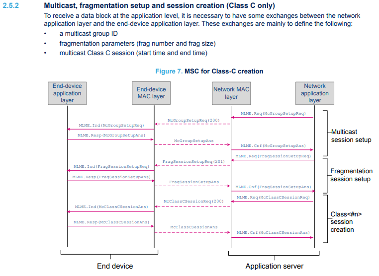

Section 2.4.4
Section 2.5.2
And section 5.1, concerning the package :

Indeed, according to the instructions given into the LoRaWAN Remote Multicast Setup Specification v1.0.0 (https://lora-alliance.org/wp-content/uploads/2020/11/remote_multicast_setup_v1.0.0.pdf), I have successfully sent Multicast commands on port 200 to the device and it has responded with the expected answers. I have tested McGroupSetupReq/Ans, McGroupStatusReq/Ans and McClassCSessionReq/Ans.
