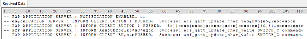

I am using the BLE_p2pServer example with NUCLEO-WBA55 and want to use USART2 instead of USART1. If I use USART1 and send a byte via HTerm, the task UTIL_SEQ_SetTask( 1<<CFG_TASK_SEND_NOTIF_ID, CFG_SEQ_PRIO_0); should be executed as soon as an RxCpltCallback event (in file usart_if.c) is triggered.

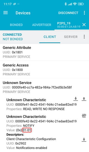

When I establish a BLE connection with the “nRF Connect” app, I receive the corresponding notification (Same effect as when I press button1)
and I also receive the corresponding logs via HTerm.
But if I now change “serial links for logs” to USART2 and configure USART2 exactly the same as USART1, I get confused characters as log information like this:

Joe_
Can you try activating Hardware Flow Control (RS232) CTS + RTS?
This can be done via MX in the UART config.
Let me know if you still have this behavior, please.
