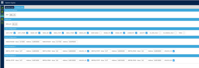

The CubeProgrammer showed that no write protection is active anywhere.
After I returned from lunch it suddenly worked. I can't say what is different now. I repeated the same steps I did the last days to run into this error. But I can't replicate it. Even attached another Nucleo board which also showed that error -> also works.

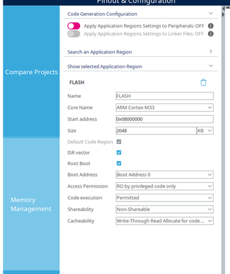

1. One thing I did is to simply set the "enable" checkbox in the FLASH section (in CubeMX). But I am unsure if that was the issue, since deactivating it still works.
2. Could you confirm that this is the correct configuration for the FLASH memory?

Thank you, could you please also send your option bytes? Do you use any memory protection?

FilipKremen
yes, the settings should be fine. Please let me know if the issue occurs again.
