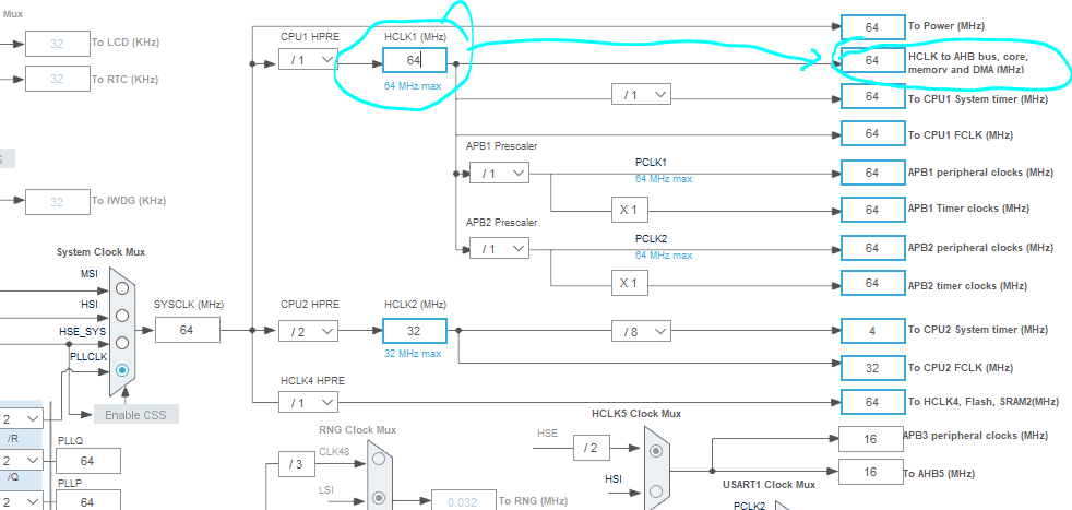

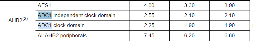

0693W00000NpuItQAJ.pngYou could run the ADC clock up to 64Mhz
0693W00000NpuJrQAJ.pngThen set your ADC conversion time to the fastest possible 2,5cycles at (64Mhz) conversion time is 39nanoseconds.
Set scan mode for the ADC to scan all 16 channels as fast as possible
Set a timer to trigger the ADC+DMA+multiplexing logic.
I would use DMA to handle the ADC measurements and move them to RAM, at the end of every conversion flag the microprocessor to send the 32x16 image trough the data bus of your choice, USB is fine i guess but not perfect, BLE is not ideal for broadcasting high vlume of data.
32x16x39nanoseconds=20microseconds per picture
Thats a theoretical 50khz resolution for your images to be taken. The real bottleneck is not the adquisition, its the how are you going to transmit the data from the microcontroller to your PC.
