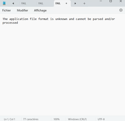

i have tried to load a simple blink led to my L0 and it work  but i have found a file .bin (rhf0m003-v3.5.13.bin) in the risinghf site and when i try to drag and drop it in the L0 it failed
is there any solution exept getting a new end node
In what way(s), exactly, did it "fail" ?
  • Failed to copy to the mass-storage device?
  • Failed to program the target microcontroller?
  • Failed to run after programming (give details) ?
  • other ?
Dan33
acutely i haven't contacted RisingHF Support but i found the file in here :https://www.risinghf.com/product/detail/19
and by it failed i mean it failed to copy to the mass-storage device
