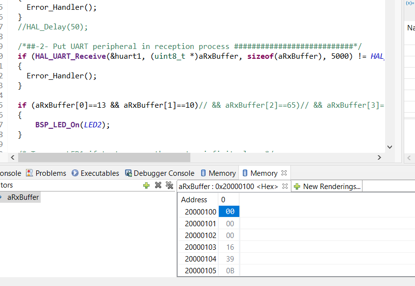

Cube IDE: Memory debug. In debug, the hexa values seen in the memory (shown by cubeIDE) don't match with the value of my variable !
LLr.1
Senior
Like you can see here:
0693W00000KZYNJQA5.pngThe LED is On so I have in aRxBuffer 13 10... (I see these values with an oscillo also..) but we can see it in the memory window...
The memory window is broken ?
Thank you

Unable to re-produce, works for me.
Can you extract some minimal reproducible example? Preferably stripping any HW dependency like UART. Makes it easier to test run. Which debug probe and gdb-server are you using?
The Memory view comes with the Eclipse/CDT platform. I dont think there is a bug on that layer... Could you also enter the aRXBuffer in Expression view and examine the data there?

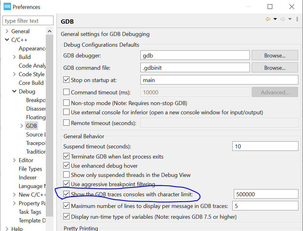

Could be interesting to have a look at the GDB traces log also!

"Could be interesting to have a look at the GDB traces log also!" -> Sorry but how to do that ?
Best regard
Enable GDB traces:
0693W00000KawUaQAJ.pngThen during debug you will get log output in the "Debugger console" view that you can submit here.
If I do the same I get this output from GDB when it reads the variable aBuffer:

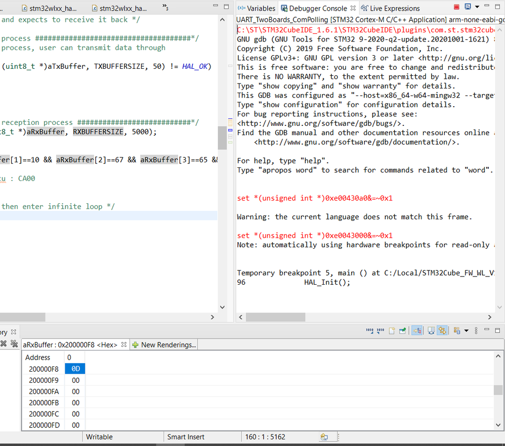

This is let's call it "raw output" read from target before Eclipse starts rendering this with different views. So if you catch the data at this level then we can conclude whether we what we read from target is incorrect or if it is only Eclipse that is rendering information incorrectly.
I think the problem is here because that is my GDB traces :
0693W00000KcTTNQA3.pngThank you and best regards
