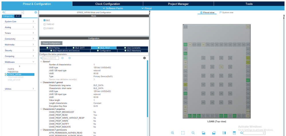

Hello all,
                  I made custom PCB board with STM32WB5MMG in my project.

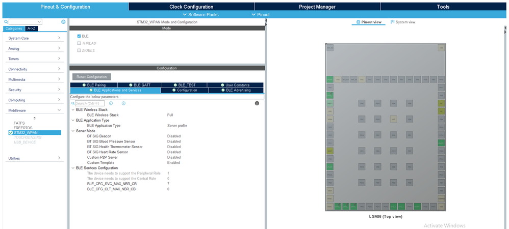

I have confirmed that the SWD pins are working and Code is Debugging ok.I have also set up HSEM, IPCC, RCC, RTC, RF, STM32_WPAN required but I can't detect the Bluetooth.
Iam using  STM32CUBEMX V6.8.1 and STM32CUBEIDE V1.12.1
Firmware package version is 1.16.0 (STM32Cube_FW_WB V1.16.0)

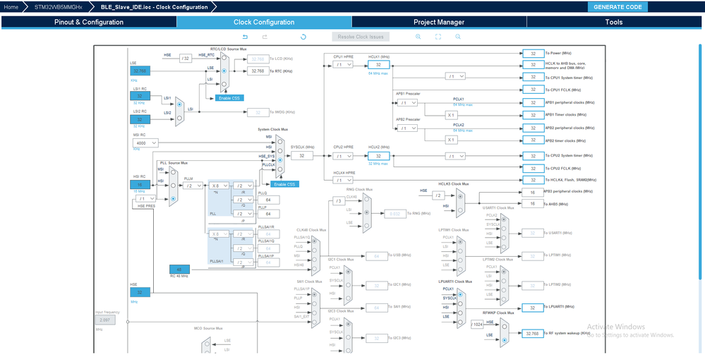

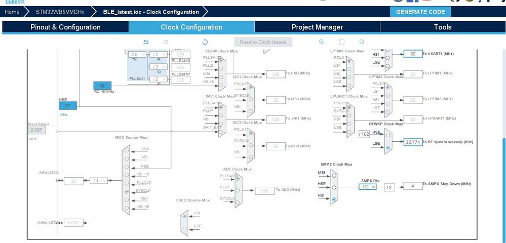

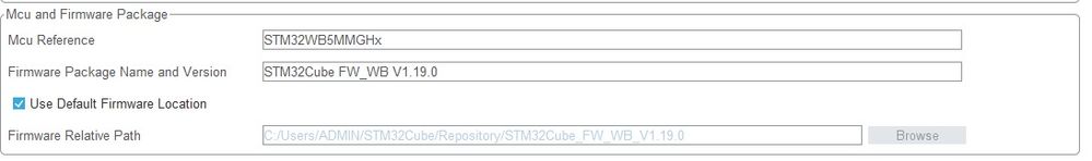

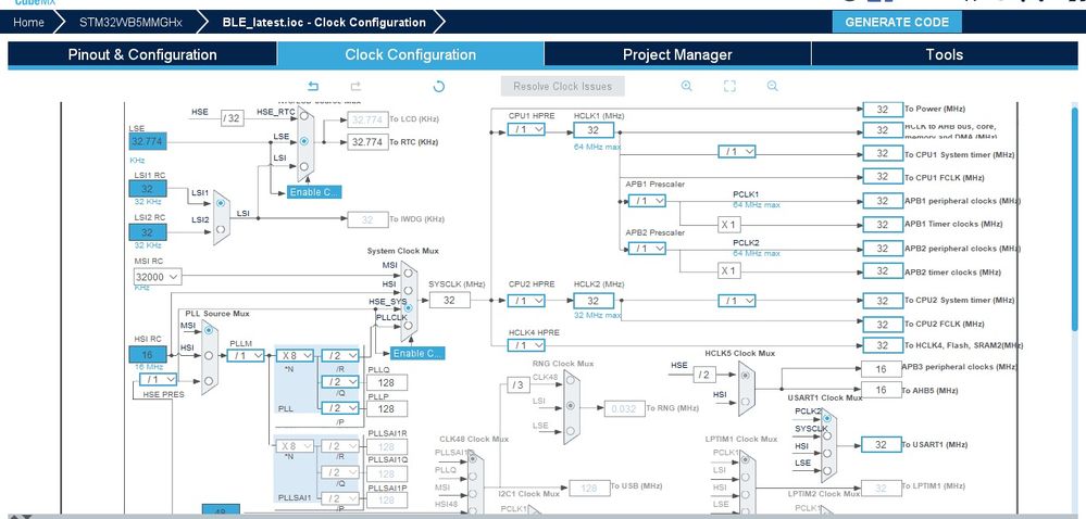

       I am trying my code in STM32Cube_FW_WB V1.19.0, the STM32CubeMX V6.11.0 and the STM32CubeIDE V1.15.0. configuration but same result bluetooth is not detecting.After I'm  trying example codes of STM32WB5MM-DK  but Im not able build and flash, so guide me to build that codes in right way.
These are screenshots of clock configuration of my project,WhatsApp Image 2024-04-01 at 6.58.40 PM.jpegWhatsApp Image 2024-04-01 at 6.59.09 PM.jpegFirmware PackageFirmware Package

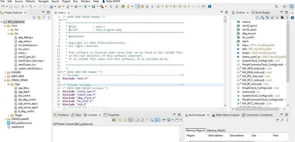

Iam Unable to build the example codes of STM32WB5MMG-DK Board,
STTwo-32
April 1, 2024
If you want to set your own example from scratch, I suggest you refer to the Steps of the WIKI mentioned on my first comment. For the BLE_p2pServer, I suggest you import it as follow:
  • File -> Open Projects from File System.
  • Click on Directory and select this Directory "...STM32Cube_FW_WB_V1.19.0\Projects\STM32WB5MM-DK\Applications\BLE\BLE_p2pServer" then select the STM32CubeIDE File and Click on "Select Folder". Then Finish.
Now, you will be able to Build your project.
Best Regards.

STTwo-32
STTwo-32Best answer
April 2, 2024
Hello @Kavinraj
Could you upgrade your FUS/Stack to the last version. Look at this video for more details.
Best Regards.

KavinrajAuthor
April 2, 2024
Dear @STTwo-32 ,
                       After Firmware upgrade,now bluetooth is detecting thankyou so much sir, If any  further doubts
I will post in ST Community
