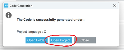

Hi there!
i start one of my new project with STM32cubeide 2.0. First i start with configure mu MCU in STM32CUBEMX in this casa STM32G031K8T6 afther i configurate all pin i create a poject . So afther i import my project in STM32CubeIde 2.0 and i build gave me this error:
Core\inc\main.h: fatal error: stm32g0xx_hal.h: No such file or directory
#include "stm32g0xx_hal.h"
 but i check with F3 and this file exist , so please someone can help me ?
Thank you
Sergio

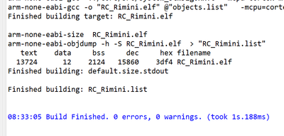

No issues generating code and building here.
After you click Generate Code in STM32CubeMX, press the "Open Project" button to open it correctly within STM32CubeIDE.
SGian.1
Senior
God bless you now an forever
