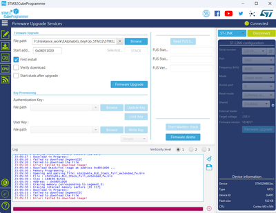

I have also tried to re-flashing of BLE firmware but receive the error in flashing.

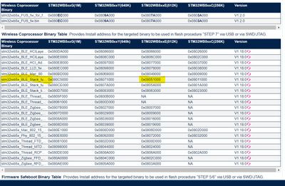

I used following link for reference and follow all steps. Also used "stm32wb5x_BLE_Stack_full_extended_fw.bin" file and address "0x08051000".
https://wiki.st.com/stm32mcu/wiki/Connectivity:STM32WB_BLE_Hardware_Setup

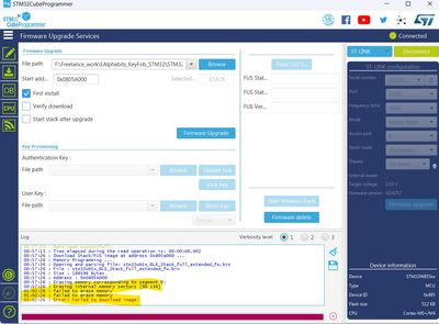

I tried to flash the BLE stack firmware multiple times but not worked in my case. It every time throw error message of erase/write operation failed.

Can you try with the latest version of STM32CubeProgrammer tool (v2.15.0) and follow these steps?
- Connect
- Start FUS
- Read FUS to check the version
- If a stack version is displayed, perform the firmware upgrade without first install option checked

According to your second screenshot, you tried to flash the wireless stack at 0x0805A000 instead of 0x08051000 as mentioned in the release note. Can you retry with the right address?
Best Regards
SjainAuthor
Jan 3, 2024 5:50 PM UTC
Hi @Remy ISSALYS ,
I tried to flash the wireless stack at 0x08051000 as mentioned in the release note. Still receive the same error in flashing. Please suggest the steps to make BLE working on my board.
Thanks,
SJain

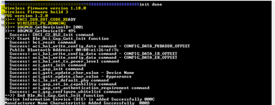

@Remy ISSALYS Thank you for the steps.
Now BLE working on my custom board after flashing the firmware.
Now only one issue I face that sometimes BLE advertisement not started.
when I debug the issue at that time I found that sometimes instead of WIRELESS_FW_RUNNING event I received FUS_FW_RUNNING event.
Can you please suggest method to receive the WIRELESS_FW_RUNNING state every time ?
Can we configured this states from application?
Regards,
SJain
