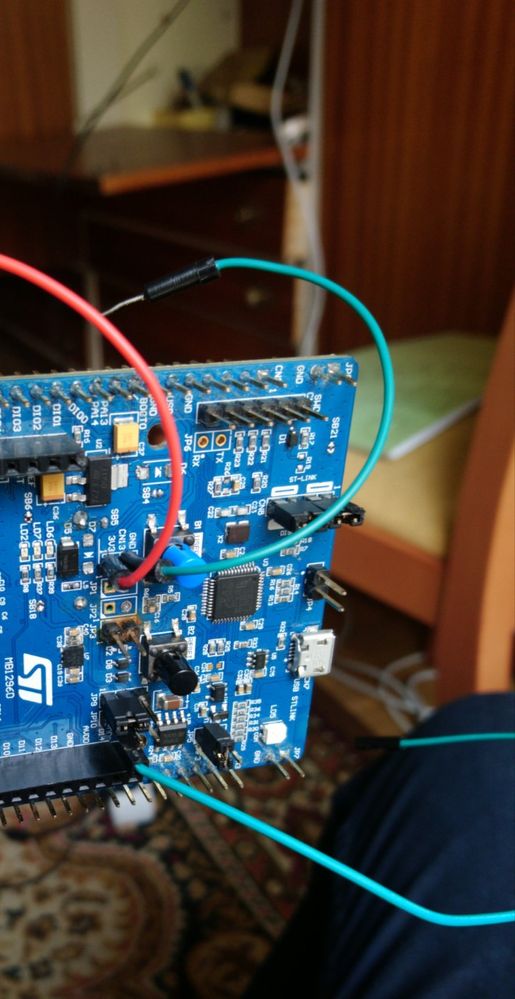

Hi, I am making some test in low power mode using the end_node example for LoRa but I always get 0.5mA in sleep mode, I use the STM32CubeExpansion_LRWAN_V1.2.1 version and I am doing measurements in the JP3 VDD_MCU_LRA branch

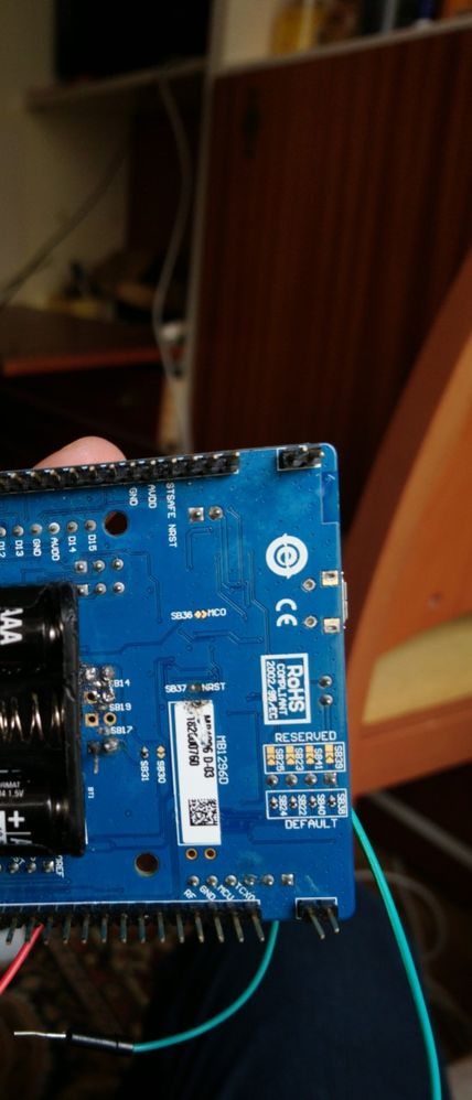

Solved!
lowest currents achieved:
VDD_MCU_LRA = 1.1uA
VDD_RF_LRA = 0.2 - 0.5uA
External power source (CN13) = 1.9uA
Problems:
1.- bad welding on jumper JP3
2.- continuous welding and desoldering of solder bridges (some of these unnecessary)
while removing the excess of tin and the jumper the current in JP3 decreased from 0.5mA to 0.1mA,but did not get lower, I think that continuous welding and desoldering of solder bridges ad components could damage another componets of the board
to achieve this:
VDD_MCU_LRA = 1.1uA
option1: (best)
Hardware:
  • R26 = disabled
  • SB18 = disabled
  • SB26* = disabled
  • JP9 = pins 1-2
  • SB37** = disabled
Power source:
  • CN13
cons:
  • if you want to program the board you must weld sb26 again
to achieve this:
VDD_MCU_LRA = 1.1uA
Total current from batteries (multimeter between the three batteries in series and BT1 pin) = 30uA
 option2:
Hardware:
  • R26 = disabled
  • SB18 = disabled
  • D2 = disabled
  • JP9 = pins 1-2
  • SB37** = disabled
  • JP4 = enabled
  • SB26* = enabled
Power source:
  • batteries (multimeter between the three batteries in series and BT1 pin)

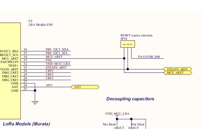

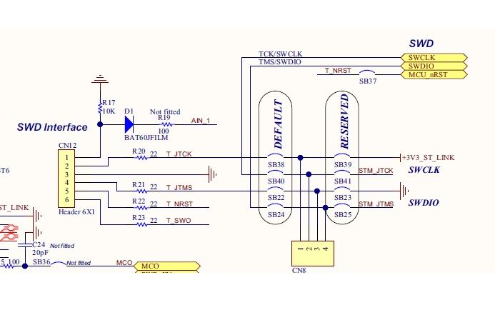

*I haven't read in your posts about this solder bridge but the datasheet specifies that if you want to power the board from cn13 you must remove sb26, option 1 is the best way to measure the currents because when you disabled sb26 it isolates all the regulators, modules, etc, and the diode D2 which consumes power from batteries
**it is not necessary to weld again SB37 to reprogram the board, if we look the datasheet of the board the pin #1 of JP10 is the reset of the MCU and pin #5 of CN12 is the reset signal from st-link so you could join them with a cable and re program the board, it fails sometimes but generally works
0690X000009jJpnQAE.jpgnote:
tested with versions: 1.1.5, 1.2.1, 1.2.2
example: end_node
it is not necessary to modify the software provided by the example
