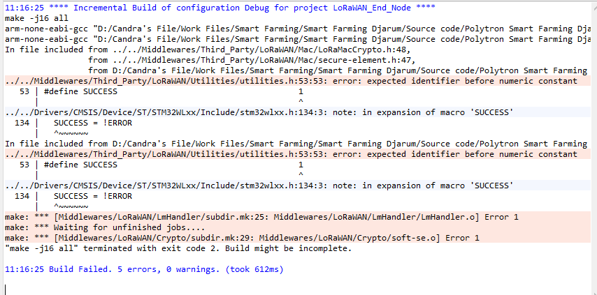

I have function to receive Dev EUI, APP Key, and NWK Key data from UART. Then, I want to put and replace of Dev EUI, APP Key, and NWK Key in se-identity.h with my own data which I have saved in flash memory. But, an error occurs when only include my own file header in se-identity.h after compiling, It also happens to when only include main.h. How can I include my own header file in se-identity.h without error ?
Or maybe there is another way to change Dev EUI, APP Key, and NWK Key without hardcode in se-identity or FUOTA ?
Any assistance would be greatly appreciated
Error occurred:

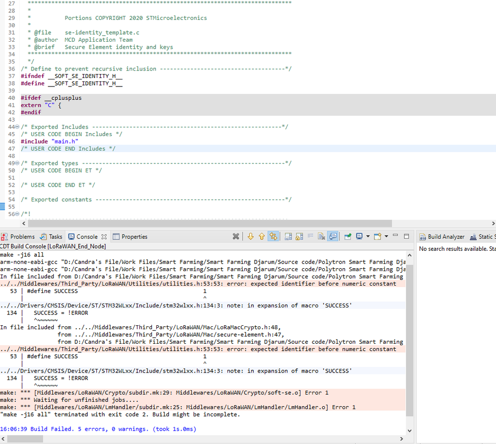

Thank you for your answer. Maybe, I want to share a screenshot of my main case. This screenshot shows an error occurred when I added #include "main.h" in the se-identity.h and compile it. Maybe there is information regarding the troubleshooting, that would be very helpful.
Louis AUDOLY
Could you try with the new firmware package STM32Cube_FW_WL_V1.2.0 please.
It's working fine for me with the End_Node and AT_Slave projects
Regards
