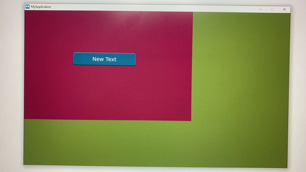

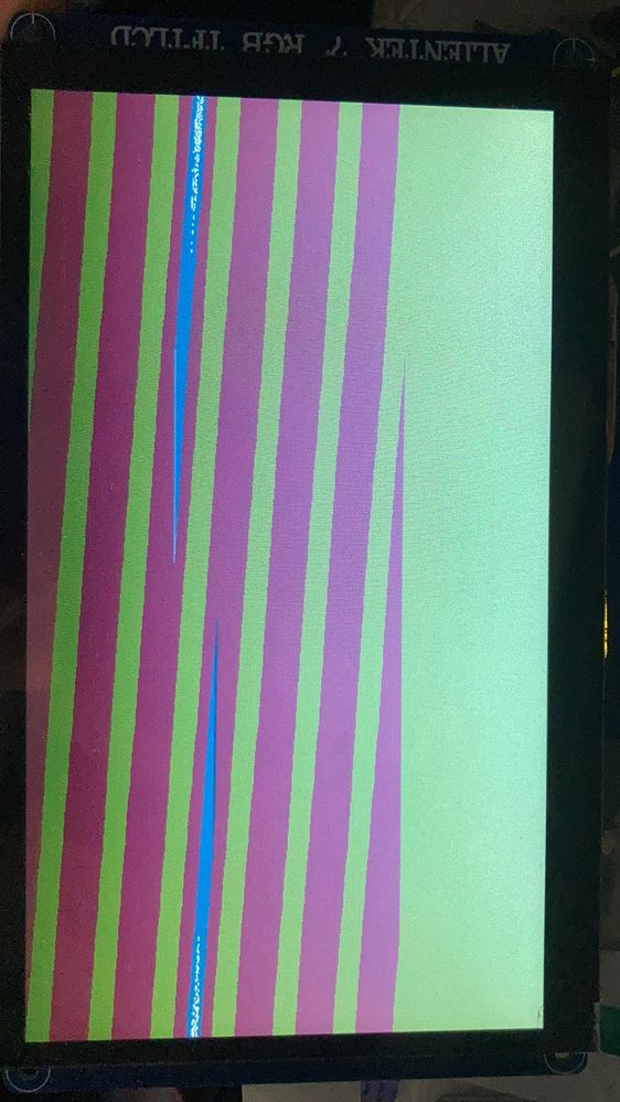

I have tried many times to configure touchGFX with cubeMx, and I was finally almost successful. My screen is 1024*600, and the driver chip is EK79001.
Now the widgets shown on display are distorting(the image seems right), as below:
But my designer is the following:

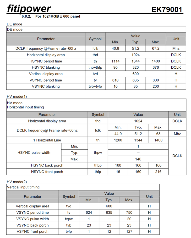

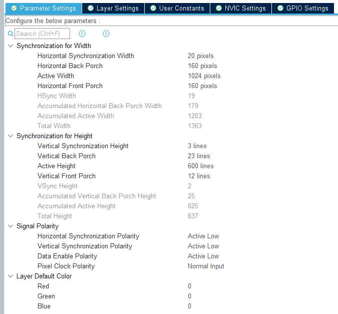

the LTDC parameters and the datasheet are as below:

Maybe the problem is of LTDC frequency or in external SDRAM config if u use it :) (its just prediction)

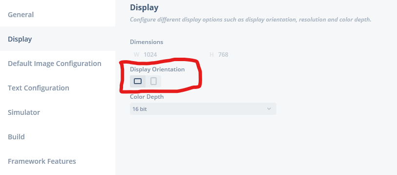

Looks like the X and Y axis are switched.
ie it is generating the raster with one expectation, and the display has another expectation

I also doubt that may the X&Y axis are switched.
So I also change the X and Y by config the "Display Orientation" in touchGFX.
But this seems nothing to help, the result is the same as before.
(I want to make sure that changing the "Display Orientation" config is the same as changing X & Y axis, am I right?)

I am using the same LCD controller.
I think you made a mistake on your LTDC setting.
Horizontal Synch Width: 1px
Vertical Synch Height: 1 line
Your other LTDC settings are the same as mine.
Just be aware that with a 1024x600 screen, you are at the limit of what the LTDC and SDRAM can do.
