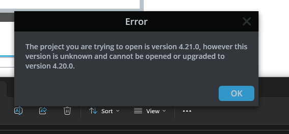

Following on from this and getting nowhere:
I tried setting up a project, using a Touchgfx example on a STM32F429 Eval board. Then starting a new project with an STM32F49IGT and then importing the 'Eval' project. After setting up all pins and functions again, I tried opening TouchGFX but it comes up with:
0693W00000Y7dhxQAB.pngI've tried a couple of times, but get the same error.
Are there any easy ways of implementing TouchGFX on a none STM standard board? i.e. a variant of the STM32F429 Eval. board. The only differences are pin out (429igt instead of Eval BGA), memory using Bank 2 instead of Bank 1, no NOR memory. I believe I have copied all the relevant code.
Anybody used Embedded Wizard in a similar manner?
Thanks
Seems you misunderstand ... STM dont have standart boards ... only demo for learning.
Normal proces for custom board have many steps.
And your error window say you what is problem. Mixing more version on your PC.
Simply is impossible help you .
Install latest designer and if you have more version open project files with right mouse click...
