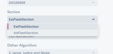

How can I have several external sections in cuneIDE?
0693W00000Y7V5lQAF.pngand how can learn to touchGFX that separates Images?
for example, 3 images place in ExtSection1 and the rest in ExtSection2.
 0693W00000Y7V7IQAV.png here we have only two sections.

I mean in designer now cant, but you can define all this in linker script.
I will make two sections in the linker script.
So, what about code? how can I categorize them?
after categorization, does the simulator still work?
In code you do nothink if files to place have own object files.
Images is generated as separate object files then in linker you can place it as you choice.

but my main problem is in TouchGFX.
image in have some data including some fonts and some images.
I want to make three sections that automatically generate and categorize by touchGFX.
1- EXflashSectionFount
2- EXflashSectionImageA
3- EXflashSectionImageB
and as you see in this code all data is labeled by ExtFlashSection.
in cases where I have lots of images, it will be useful.
I guess touch gfx is unable to categorize data into different sections.

??? if you place image_concitroen.o in linker file to other section , code pragma is ignored.
And normal project have FontSection, IntSection and ExtSection
you in linker file can use IntSection as ExtSectionB and in TochGFX every image assign into ... open images and scroll to right.
