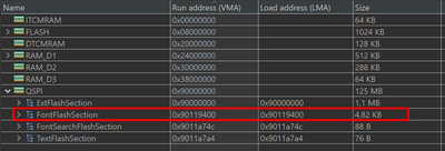

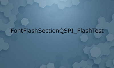

I've created a test touchGFX project for stm32h747i-disco by using TouchGFX Designer-4.21.4. It has only one screen that has one background image and one text. You can see it below:
When I generate the code by using TouchGFX Designer-4.21.4 and when I compile and download it with stm32CubeIDE, it works without any problem.
But when I write this linker code to move FontFlashSection into QSPI flash memory, it stucks in the ErrorHandler.
FontFlashSection :
*(FontFlashSection FontFlashSection.*)
*(.gnu.linkonce.r.*)
. = ALIGN(0x4);
} >QSPI
ExtFlashSection, FontSearchFlashSection and TextFlashSection work in the QSPI flash memory without any problem. But when I add FontFlashSection as well to the QSPI Flash, the code somehow stucks in the ErrorHandler.
What else should I do to use FontFlashSection in QSPI Flash memory? What am I missing? Can you help me for this? I need to use FontFlashSection in the QSPI Flash memory. Thank you for the answers :)

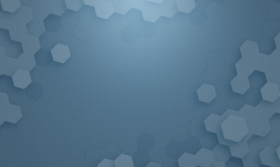

} >RAM_D1 AT> QSPI
I think we made some progress because the code does not stuck in the ErrorHandler anymore with this linker script. But I have another problem now. It works, I can see the screen but I can not see the text anymore. Do you know or have any idea why I can not see the text in the screen anymore?
I also tested the linker script with other RAM sections (RAM_D2, RAM_D3, ITCMRAM, DTCMRAM). The result is same.
And yes, MX_QUADSPI_Init() is being called before the MX_TouchGFX_Init().
2024-05-10 7:50 AM - edited 2024-05-10 7:50 AM
As i said, this sentence in linker script set in code address for reading fonts from RAM, but RAM is empty after sw start, because system loader not preload from QSPI. This must do your code in main before use fonts...
Simply after init QSPI memcpy fontsize area to ram choiced in ld.
2024-05-10 8:18 AM
It works!!! Thank you so much :)
