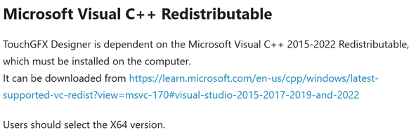

MM..1
October 12, 2024
Maybe try this
October 13, 2024
