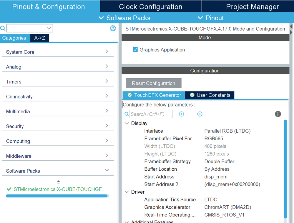

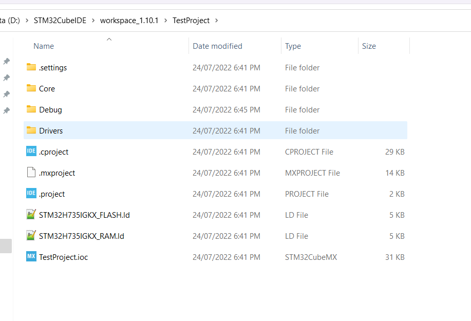

I have tried this way too..
Steps
  1. Create new ST32 Project int CubeIDE
  2. Select Components > TouchGFX fromSoftware Packs (see image)
  3. Save project
  4. Build project
It is my understanding that a TouchGFX folder / files should be in the CubeIDE project?
Is this correct? Or Missing some steps?

Yes you miss some steps.
Normal way is:
  2. Config HW and LCD to work state in MX wizard
  3. Save project ... generate
  4. Build project
repeat 234 to working LCD
  1. Select TGFX component as on your image and OK
  3. Generate project MX
  4. Refresh project tree in TouchGFX open new template
  5. generate in TGFX and close
  6. Refresh project tree
  7. Build
  8. Next edit TGFX no over template , but over .touchgfx file

You skip Configure Software pack0693W00000QM02ZQAT.pngand ...
OK, got it now.. thanks for your help :)
